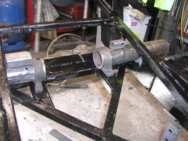

Progress a bit slow at the moment.
To allow the rear prop a clear run, had to chop the rear axle tube into two parts and use extra saddles for support plus extra bits (weight) to the chassis.
As it was apart used some chassis black to cover up the my welds.

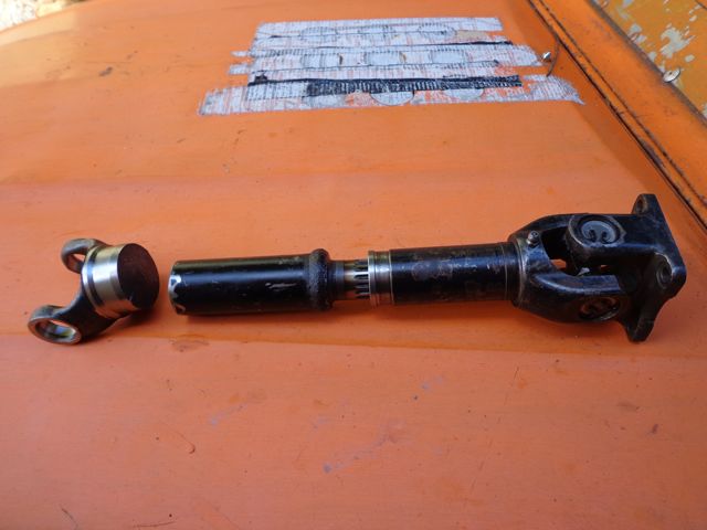

Prop Shafts
After a lot searching/phoning have the parts for the props.
No comes the hard part fabrication,

Rear Prop made and fitted.

Middle Prop.

Top Prop.
Needs the inner yoke turned down to fit the tube with a visit to my machinist man.

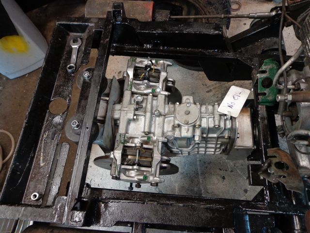

Rear Brakes.
Fitted Discs + Adapters + Calipers + Pads.
Havent got any retaining pins or springs.
Used some studding for the Pad retaining pins, do I need the springs??

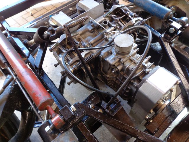

The non Citroen parts of the project, the transfer box.
Before
Some Cleaning..
In bits
Replace seals and check the bearings and work out some way to lubricate the top bearings.
@brammie
can't help noticing that you placed the T-case in an upright position!
you know the oil won't come up to your upper barings this way?

Depends if you'll be bothered by some squeaking from the pads if they move into light contact with the discs, due to the vibration as you yomp across the scenery... :lol:
subarupete wrote:
Rear Brakes.
April 21st, 2012, 3:19 pm
Posts: 2257
Thanks Ken,
Got the calipers (NOS) on ebay some time ago £15 :D .
Will see how long I can put up with the squeaks?
