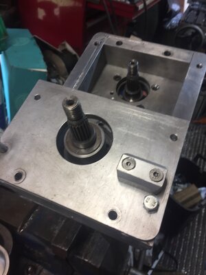

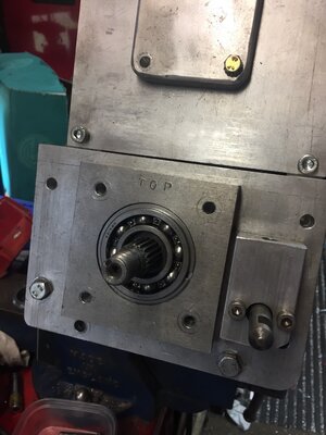

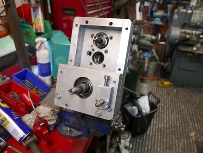

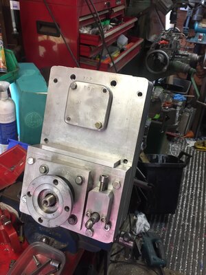

Output shaft selector mechnanism...please ignore the cock-up bottom left :(.

June 20th, 2024, 3:21 pm
Posts: 2300
It's no cockup it's an extra oil reservoir.
June 20th, 2024, 5:28 pm
:D.........like Half-Full/Half-Empty
June 20th, 2024, 5:56 pm
Posts: 508
Location: Korpilahti, Finland
With this small extension of gearbox, the original amount of oil might be need to put two or three times..?
Looks very nice, waiting to see it completed...
June 20th, 2024, 7:15 pm
Good point, maybe an extra 0.5 litre?

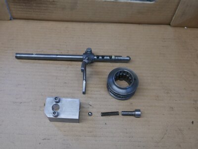

June 21st, 2024, 8:35 am
Selector interlock...Citroen copy :)

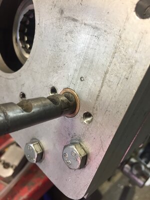

June 21st, 2024, 7:48 pm
Spent few hours making the rear bearing retainer :)
but its a cockup as the 7mm bolt holes are not in the right plac- (-/+2mm) :((
But fitted and "O-Lite" bush for the selector rod:)

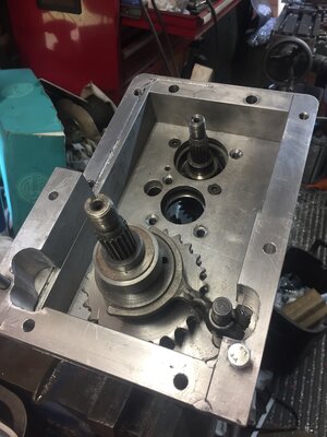

The old grey matter gets confused.....
Took is all to pieces, CLEANED all the surfaces and bolts and threads.
Re-assembled carefully....
All all fits and rotates :O
Will look at the "athsetics" and radius the corners and edges ec..,
June 23rd, 2024, 3:29 pm
Posts: 1203
SUPER !

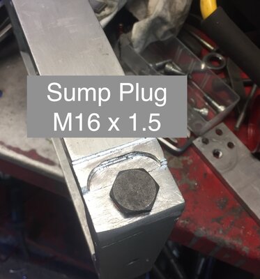

Must make a list of parts to make or finish......
Today drilled and tapped M16 x 1.5 and fitted a sump drain plug..
