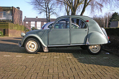

Did already, mounts are ok. The worst it is in changing gear down from 3 to 2. All the other changes are rather normal.
