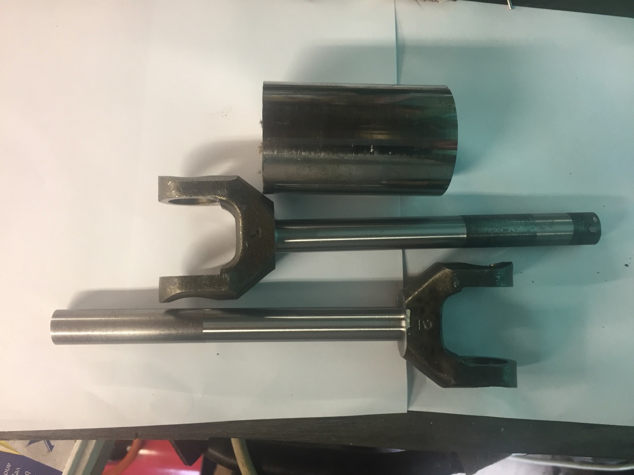

Can't make the exhaust till the body is sitting on the chassis and can't do that until I have a transfer shaft fitted.
What is required, "the middle part".
But, not happy with getting it welded.
So have to machine one!!

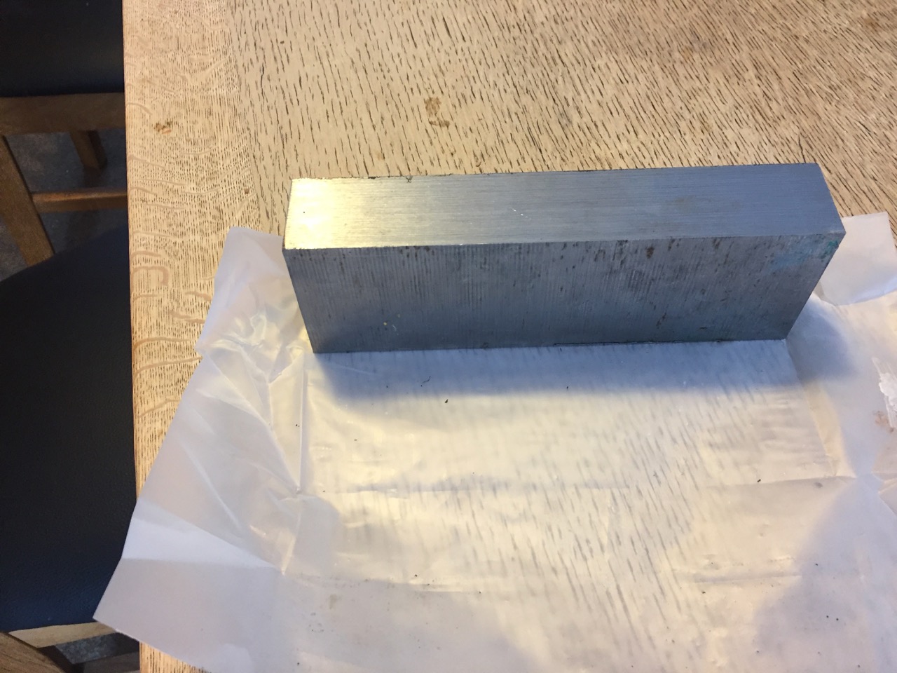

Purchased a bit of steel..
Some difficult milling/turning/drilling and lot of Google.
Bit of a challenge but nothing ventured.....

Posts: 2251
Hi all,
Back again after a long period of no work on the off-road car or the road car.
Turning & Milling required to join the two uj's to make the shaft between the clutch shaft and the remote gearbox.
