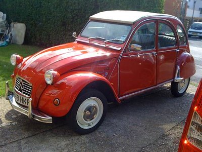

I thought since I keep cluttering up 'what have you done today', I should start my own car thread.
I've had this 1989 Red Special for the best part of 20 years now. To be honest I really hated 2cv's before, I've always been more of a straight 6 or V8 kind of guy. But my friend was selling his, I bought it for £100 and it was a truly awesome little vehicle which cost so little to keep. (Really I had wanted one of those cool 60's Fiat 500's but expensive!)
Eventually it expired so I bought this replacement, which was very similar apart from having disc brakes and round headlamps.
This little thing has been through thick and thin with me, the most faithful family servant, serving in all weathers driving from Reading to South Devon. It took me and my Mum down to see my brothers, and carted us all around down there endlessly. Plus a large hound dog.
It had only 26k miles when I got it! But needed a bit of love - awful starting. It let me down so many times. But basically it just needed use and fettling.
It was in great condition though with so few miles. It has about 110k now and is in fine health, apart from the rust holes that keep appearing! Unfortunately for me it was a Portuguese built example and i hadn't heard of the rust problems particular to those cars.
I've kept it highly polished and paid attention to every detail, but nonetheless I am now having to do bodywork patching quite a lot recently.
I cant really complain, its seen a lot of very harsh winter weather. Honestly, there were times when this little buggy was the only thing that could come and go in some places in Devon! Snow, wild mental wind and howling rain, flooded lanes. I even had a massive wave break almost on the car once as I was driving along. My friends lived in a woods for a while and the Deuche was great at slithering in and out of there.
Here is a pic from I think around 2008 or so.

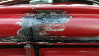

Bloody rust.. Last year I tackled the bulging rusting filler areas, deteriorated from when my garage did them quickly for me. They'd also done the area under the rear quarter window - a large hole was appearing there now. I discovered the window aperture was completely missing. I had no idea the windows were so easy to remove - thanks to advice on here.
Water had come in the window and run down the rear sweep, causing rust to start on the whole panel. Did also explain why water would run down from the rear of the car into the front floor area sometimes.
I did this rust, got a reasonable result with filler but then ruined it with 'knifing putty' from Halfords. Honestly, i don't know if it was user error but it was diabolical. Awful, and ruined all my carefully sculpted filler. I've checked my a bodywork artiste I know and he said nah he'd never use that these days - good filler wouldn't need it. lesson learned!
I painted it with cans from Ecas - Did the whole rear sweep on that side, including the ends on each side where it had rusted too. Not a bad match for an aerosol. It was ok for a first effort at painting, but not exactly amazing and I was annoyed at the mess the knifing putty had made.
Some rust above the B pillar. this is actually the better side by far really, but it was heading the same way. the other side was dramatically worse for being covered with filler but essentially untreated.
This side is also a bit wonky from being tipped on its side, but that's beyond my skills for now.

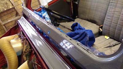

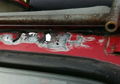

Just recently I was driving back from Devon and water was coming in - awful weather. It was coming in via an odd place and flicking into the car. When I checked it out later and had a bit of a poke, this is what i found. On each side actually. No surprise there then! Lol.

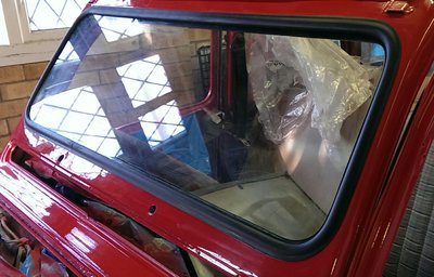

Been meaning to do the windscreen surround for bloody ages now so I thought bollocks to it and borrowed my bosses garage for painting and stuff. It was a mess but i just aint got the money or the ability to get it replaced so I did what i could.
I use POR15 a lot. Also stuff from Bilt Hamber which works well - a rust curing thing. Actually after experimenting this time, and checking out old rust holding attempts on the car, I find that POR15 works better directly to well prepared rusty metal - I'd stupidly been using the converter underneath which kind of defies the point of POR15 really, and I'm finding POR15 is longer lasting by far if done right.
I'm really pleased with how it came out - it has taken so long though, much longer than planned. Curing times, reactions in the paint here and there, runs, general learning curves! Lol. Endless sanding!
