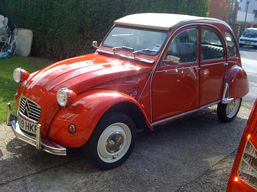

Here is a pic from I think around 2008 or so.

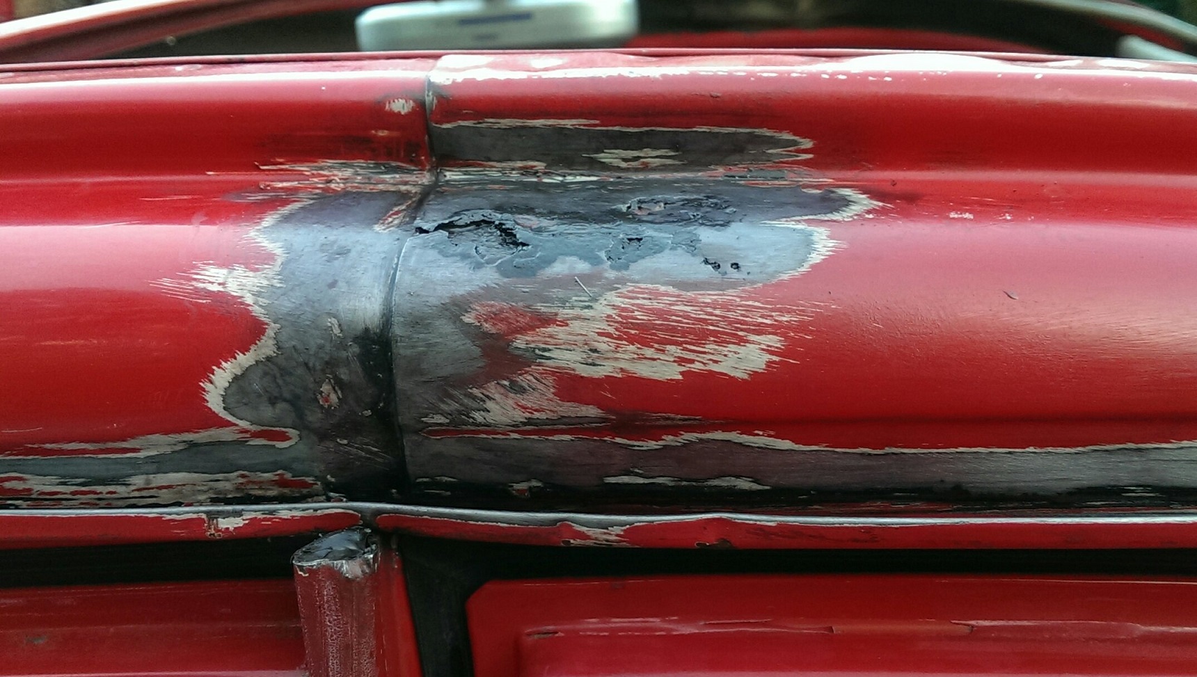

Some rust above the B pillar. this is actually the better side by far really, but it was heading the same way. the other side was dramatically worse for being covered with filler but essentially untreated.
This side is also a bit wonky from being tipped on its side, but that's beyond my skills for now.

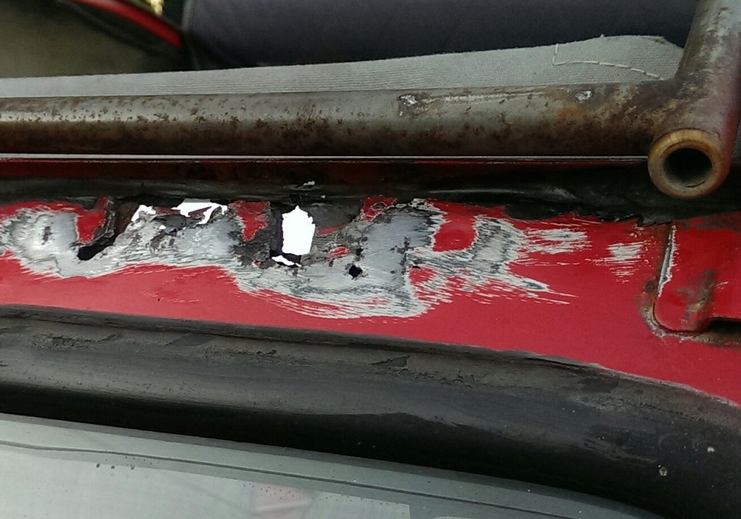

Just recently I was driving back from Devon and water was coming in - awful weather. It was coming in via an odd place and flicking into the car. When I checked it out later and had a bit of a poke, this is what i found. On each side actually. No surprise there then! Lol.

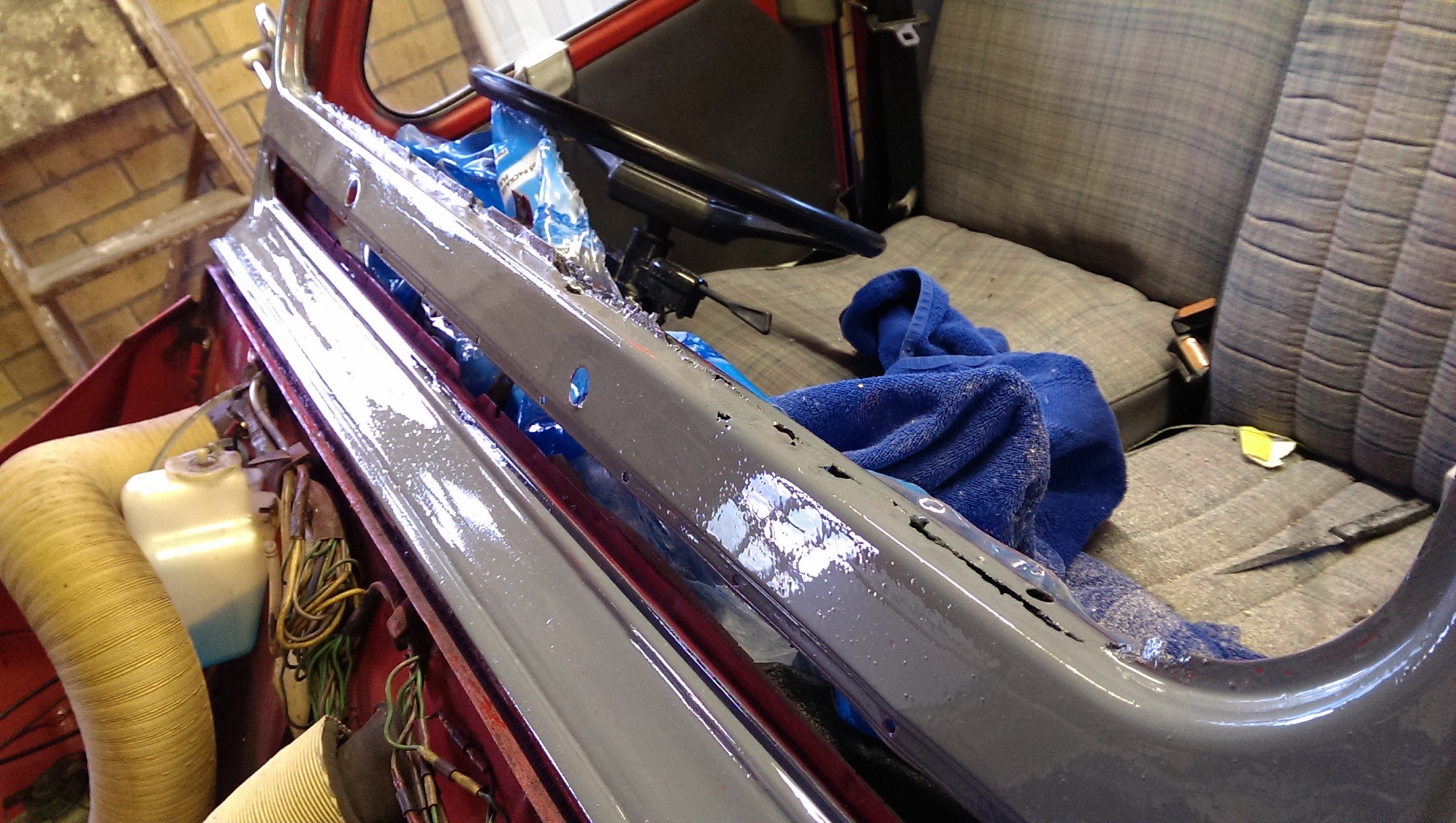

Been meaning to do the windscreen surround for bloody ages now so I thought bollocks to it and borrowed my bosses garage for painting and stuff. It was a mess but i just aint got the money or the ability to get it replaced so I did what i could.
I use POR15 a lot. Also stuff from Bilt Hamber which works well - a rust curing thing. Actually after experimenting this time, and checking out old rust holding attempts on the car, I find that POR15 works better directly to well prepared rusty metal - I'd stupidly been using the converter underneath which kind of defies the point of POR15 really, and I'm finding POR15 is longer lasting by far if done right.
I'm really pleased with how it came out - it has taken so long though, much longer than planned. Curing times, reactions in the paint here and there, runs, general learning curves! Lol. Endless sanding!
