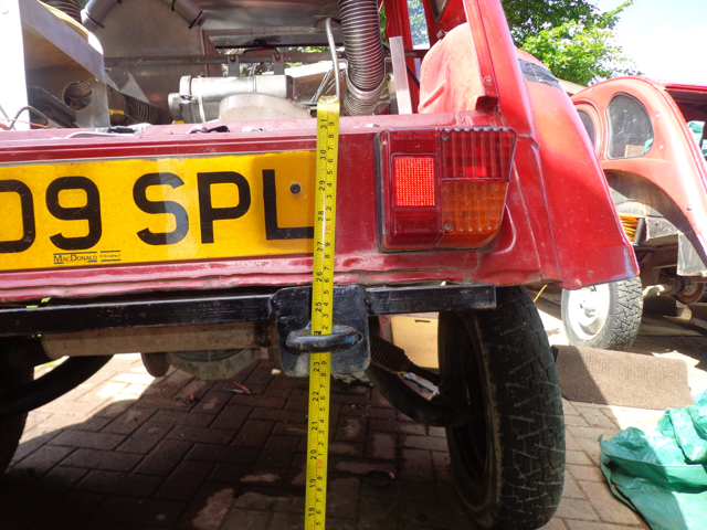

Measured Max and Min not the most extreme but happy with the result, with total of 20cm at the bumper.

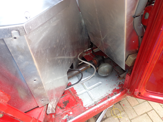

Cut the engine covers and tried the seat, all seems to fit.
Need to postions pipe work and fasten down with clips.
Control Box with Up/Down buttons for each side
