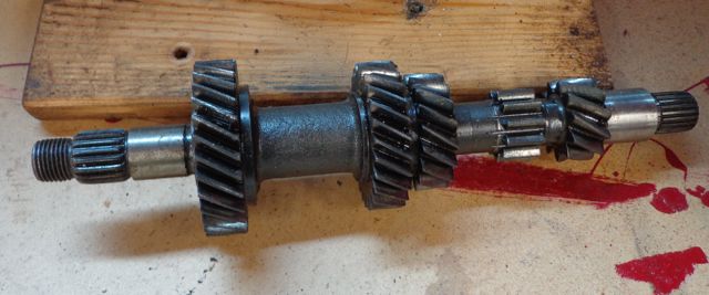

Redundant Layshaft.
Lay shaft cut down to make new input shaft
