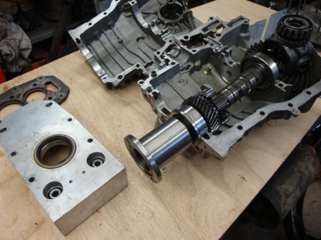

Rear end of 5 speed box

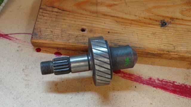

Redundant Layshaft.
Lay shaft cut down to make new input shaft

Drive Flange (internal splines to fit pinion shaft.)
Drive Flange fitted fits 1100 UJ flanges
