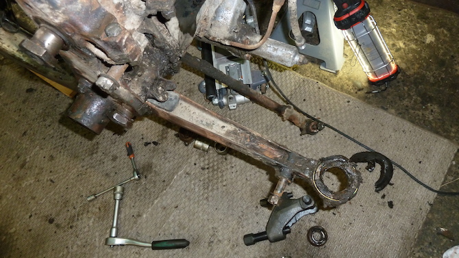

Then the lower swivel joint using another special it tool - but they do work without any hassle at all.
Out with the driveshaft onto the bench leaving just the lower suspension arms which are connected to the torsion bars - I will probably be leaving these connected as they are a pain to remove and not much point really other than cleaning them up.
