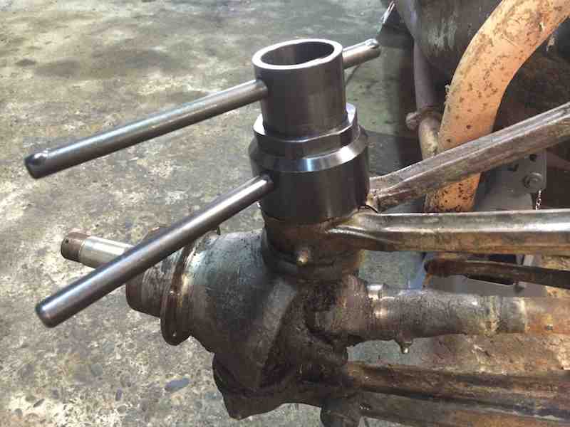

Couldn't resist one last thing - got my new tool to take off the cover of the top ball joint.
It works perfectly, much better than a hammer and chisel :D

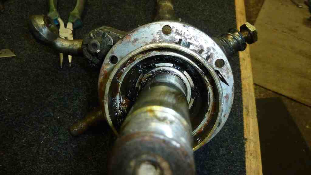

Now I have the drive shaft (a big version of my little AZU) on the bench and now to figure out how to get the inner wheel bearing out. (I have new outer and inner units to fit after a full clean up of the shaft)
I need a special too 1826-T to remove the castle nut buried deep in the stub axle and then I think I need a multi tool to remove the stub axle and retrieve the inner bearing - this is for another day (had to service a liens bike before I take him to airport at 6 in the morning).

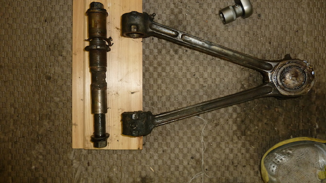

Out with the driveshaft onto the bench leaving just the lower suspension arms which are connected to the torsion bars - I will probably be leaving these connected as they are a pain to remove and not much point really other than cleaning them up.

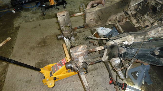

After disconnecting the torsion bars from the rear of the engine bay, the front end is ready to come off. There are 4 big nuts that come off and that is it.
Easy does it - the front end slides off the body.
I can now get into the engine bay and strip it, clean it and paint it. I can also just lift the car by hand, the front end is bloody heavy.

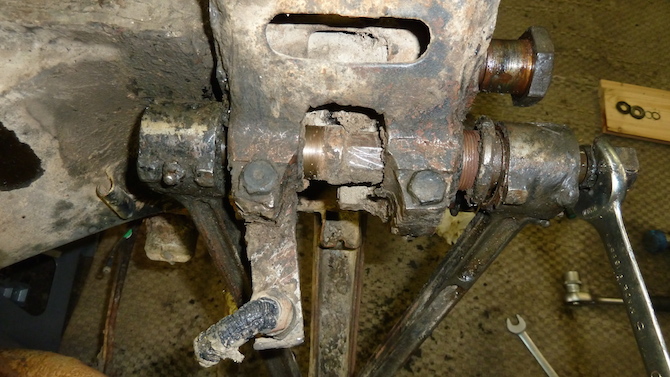

Having big problems with the silent Blocs and the torsion bars.
I need to change the 4 silent blocs on the front end. They are supposed to just prise off with a bit of force but the bloody Torsion Bar came out first (not supposed to budge).
I am going to take it to a club member who has a press - hopefully that will solve it.
