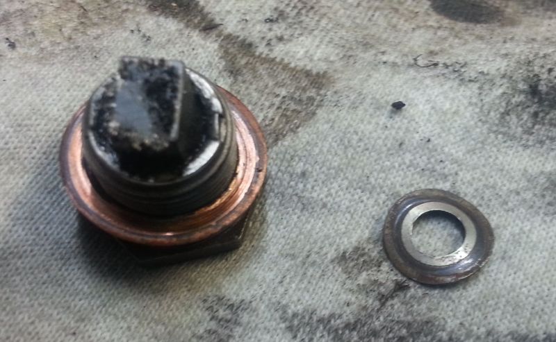

Thought I'd first of all drain the gearbox oil before removing the end plate. The problem with magnetic drain plugs is that sometimes they hold a nasty surprise.
This one was holding a small (about 6mm) washer of the springy semi-domed variety.
Anyone care to surmise where from? Are there washers this small inside the gearbox or is it possibly a stray cover plate washer that's fallen in and been missed, sought, assumed to have fallen under the bench and ignored?
And as the post said, should I be worried?

no gear-tooth marks? so hopefully just sat on the magnet

2. Looks like one of the two 'Belleville' type spring washers which should be fitted on the gear lever side of this linkage...
http://www.ecas2cvparts.co.uk/repair-jo ... -1480.html
Some careless work by a previous owner or a partially sighted mechanic?

1. No tooth marks so yes, I believe it's had a quiet life magnetically attracted.

3. Certainly looks like one side from the gear linkage. I can imagine a scenario where the cover's been removed in situ and the gear linkage hanging above detached temporarily I suppose.

to clarify, there should be both a spring washer and plain washer on each side of the rubber bush.
Perhaps the original 'washer dropper' assumed there should only be one on each side, so never realised that one had gone awol?
