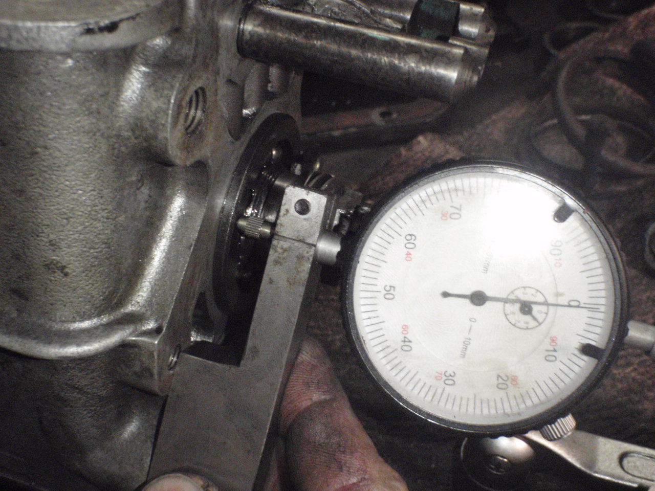

When I stripped down my box the other day, I read that there would be shims in the end cover to hold the bearing in place but when I carefully removed it hey presto - nothing????
May 20th, 2014, 8:09 am
Post Re: Should I be worried?
Rear covers on modern gear boxes are machined not to have any shims, whereas earlier boxes need shims
