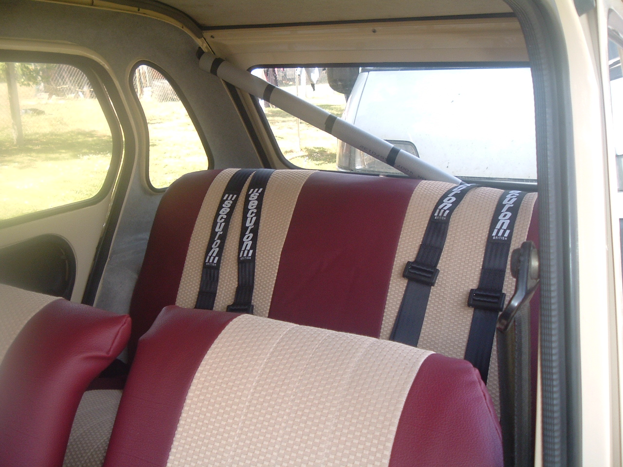

I have 2 x littlens 3+6 yr olds, I really want to mount some enertia seat belts so they can come along for rides, any idea what type of seat belts I need ( any from the scrapyard fit) or do they need to be specific to the car also where do people mount them?

I mounted 2 rally type harness in the Dyane (the kids love them) I made a strengthen piece for the middle strap and mounted it to the inner wheel arch - right at the back

Thanks Chris, very interesting, I'll see what I can cobble up for the kids I think.

These are ones I bought
http://www.ebay.co.uk/itm/NEW-Securon-6 ... 3cb5f3e265
Plenty of adjustment for with or without booster seat.

I have a pair of harnesses like the pic above, my nipper rarely travels in the 2cv so we could probably hook them up in your car.
