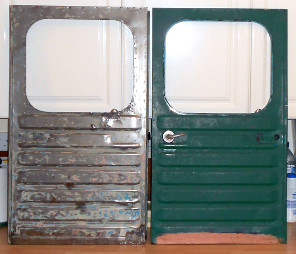

Look what I've been doing this afternoon:
One problem: Nitromors costs a flippin' packet, and as you can see I ran out before I finished the job.
For the other door I'd like to try a home made version. Would this work on car paint?
1/2kg household lye (caustic soda)
2-4 boxes of common cornstarch (cornflour)
10 litres of warm water
1 great big plastic bucket

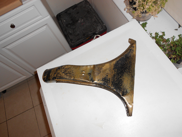

Three weeks ago:
Well, 3 weeks after I dropped the rusty bits into the butt full of molasses/water, I just got them all out and gave them a light scrub with my trusty Lidl scouring pad. Amazing! The rust literally melted off, leaving pitted but very clean metal.
Probably the worst bits were the battery trays. They're now looking splendid, eg
(Note the bloom of rust already forming, just minutes after I'd finished - treat the metal immediately after cleaning!)
So now I've given them all a quick brushing of Fertan to protect them, and they're drying in the kitchen.
Conclusion: really easy and effective way to treat rust. Dump it in and forget it - the longer the better.

At last a more or less serious test with molasses !
How is the test with the two reardoors and the home made stuff progressing?
October 19th, 2012, 9:24 pm
Post Re: 1976 AZU250
Hmm,3 weeks.Thats probably why mine wasnt as clean as yours.I cleaned mine after a week,it was ok,but not as shiney as yours :o .

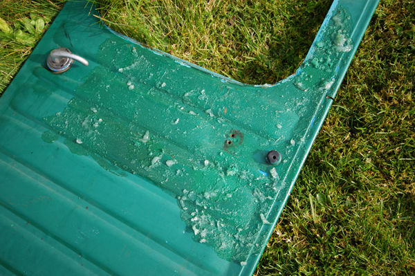

Right. Here is the report of my gloopy caustic soda, cornflour and water mix experiment.
The door that I worked on had been painted green. Here's a shot of it with some gloop on it.
The caustic soda mix caused the green paint to literally melt off amazingly easily. However, the original car paint underneath just would not budge! Most frustrating.
Now, caustic soda is a strong alkali - so I guess I'm just going to have to find an acid-based gloop to do the job on the car paint. My dad is a retired chemist, so I'll see if I can tap him up for a recipe. Will keep you posted!

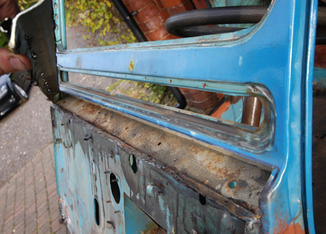

Couldn't go and mess about on the vehicle today, so I worked on the back doors. One of them is in a bad way at top and bottom
so I cut out the rotten pieces...
Anyone know where I can get replacement pieces for these, along with a rippled section of floor for the back of the van (approx 60cm x 30cm)?
