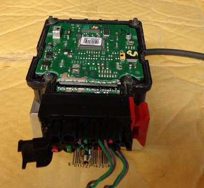

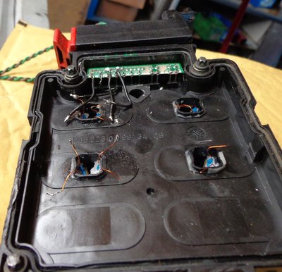

Discard electronics. Selected Valves that close the brake line, so that you can brake each wheel independently and also a valve to block the fluid return to the master cylinder.
Coil 7ohm/5volts.

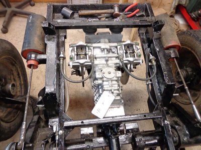

Hydraulic pump

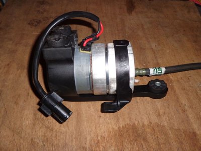

Individual lines to calipers

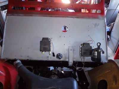

ABS unit and pump on Bulkhead x 2

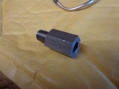

Adaptors for blake lines

Maybe you could use any Bosch ABS modulator, even with LHM.
They have the pump built in. The pipe connections may have seals, but these could be replaced with LHM seals.
The valves and pump, I believe have no rubber parts, but will dismantle one to find out.

S-P-Traction.. So far..

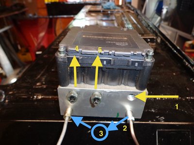

Pipes on ABS unit.
1. From master cylinder
Via stop valve
2. To pump
3. Pump
4.To left brake (after stop valve)
5. To right brake. (after stop valve)
No power to abs unit allows brakes to work in normal manner, ie pass thru.
With power
Check valve between 1 and 2 closed.
Pump on
Valve 4 or 5 operates to brake the wheel.

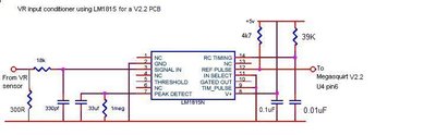

Some Logic to workout what the wheels are doing?
