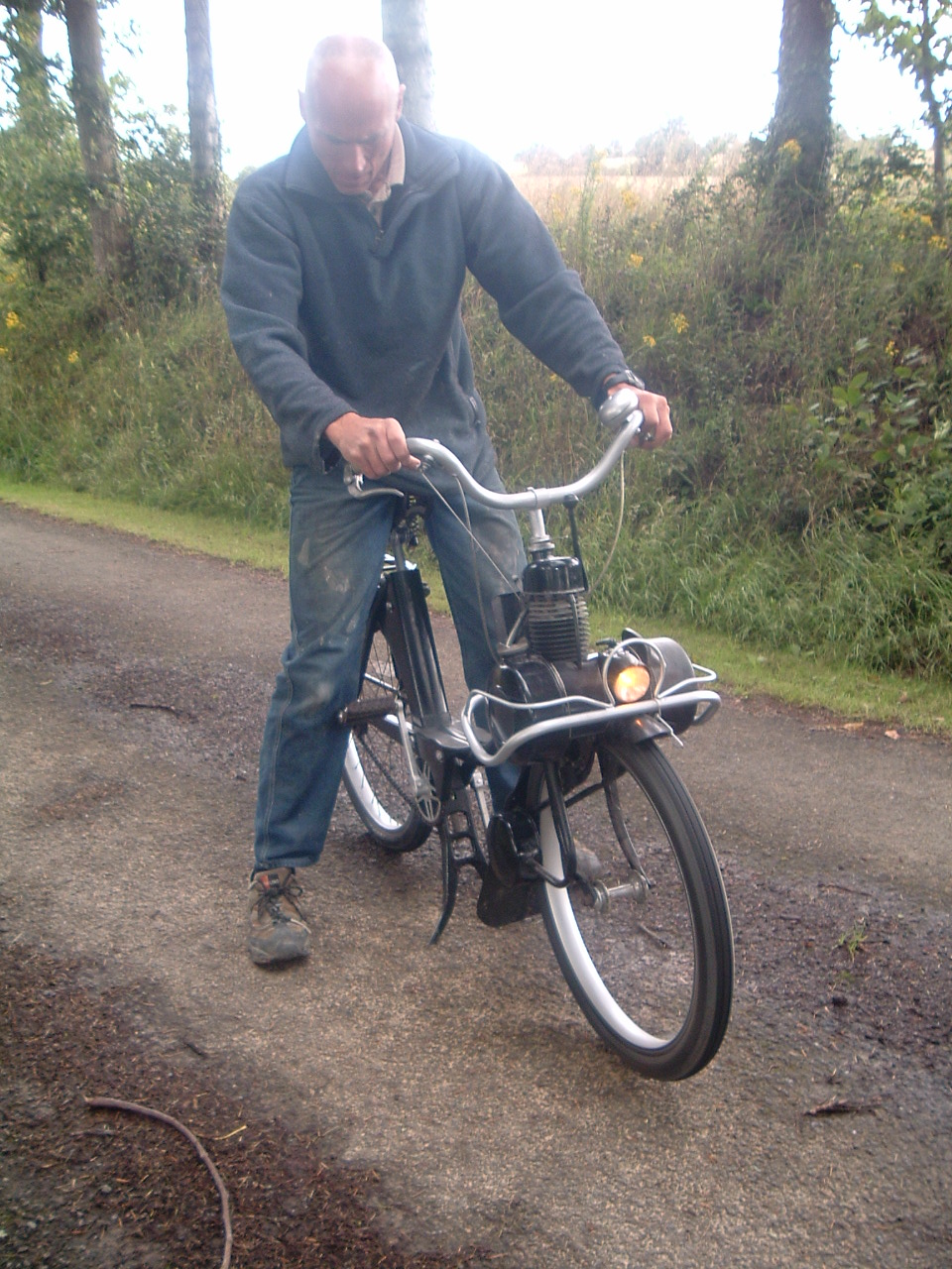

Here is my 1961 S2200 - I bought it as a 50th birhday present for myself last year. It was made in the same year I was born. Its had some work done but most is original (not perfect but OK). I use it to go down to the coffee shop when the weather is good or down to the Bay de Mont Saint Michel. The only small problem with it (and I have seen the same on Solex forums) is to get it to run right I need the choke half way sometimes.
Like the Dyane it makes people smile.....
