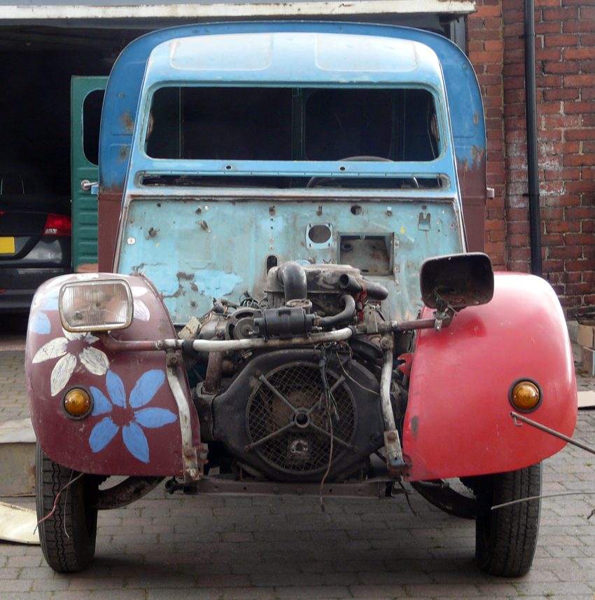

Right, starting to get down to the real business of getting the 250 on the road.
Having prodded about and pissed myself off with the remains of the red Special I thought I'd go and take a look at what I actually bought last October. It's been 6 months since I last looked at it. After buying it I simply towed it to my Mom and Dad's and stowed it away in the back of their garage, then got on with other things in my life.
Well, here is what I pushed out of the garage:
Looks quite cute with all that foliage underneath it, doesn't it? Nice back wheel!
Still kind of torn about what to do with it, in spite of pondering the problem for several months. Shove the red Special's 602 engine and disk brakes in it (in quite good nick), or take a punt on the original engine and gearbox and see whether I can get them going?
First things first. I had a little prod around and emptied all the bits that were in boxes in the back.
Seemed like a good idea to just see what it's going to look like, so I had a mess about with the wings, and got the lights out. Don't worry, there are replacement light units in one of the boxes.
There's also a spare back door, all the glass (apart from the windscreen, bah!) doors, spare doors, two seats plus a bench seat, 3 speedos (2 Club-style - the original one in kms & another in miles - plus a Special-style) 2 bonnets and plenty of other nick nacks. The wiring loom is all there, too. There's even a 10L can of two-pack & hardener in the right colour. More or less, it's all there, like a giant lego kit, but without instructions.
The underneath's looking good:
In fact, it's all looking as solid as I remember it was when I bought it, so at least I can reassure myself that I wasn't suffering from Buyer's Delusion when I made my purchase.
The body shell is very solid indeed - the only bits of rust on the exterior of the van are just surface spots, which someone had a go at with an angle grinder by the look of it prior to selling it to me... the only bit that's a bit of a concern is the slightly ratty bonnet hinge and some dodgy seams over the top of the back doors.
The inside is looking like it's seen a bit of life.
I decided that the best thing to do with the remains of the day was to stabilise the surface rust. So out came the trusty bottle of Fertan....
A few minutes later and I could see progress.
Tomorrow I'll go back and wipe off the Fertan residue and marvel at my solid, if rather safe, start to this project. I'm playing myself in, giving myself time to focus on what the heck to do... and then I'll have to learn how to do it!!
At the moment, I'm thinking I'd like to chuck the 435 back in (if it works... that engine really does look a bit knacked) and get it all mechanically rock solid, but leave it looking as agricultural and original as possible, with its authentic patina.
That bonnet seam's gonna wake me up at 3am though, I can tell!
