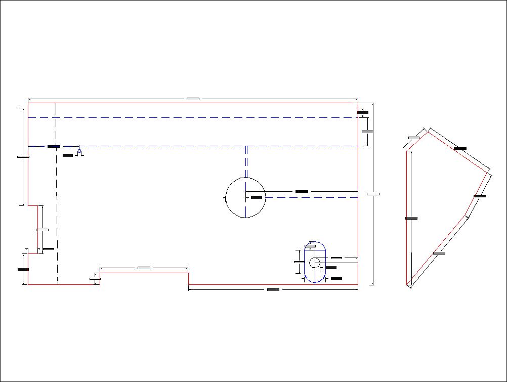

2. Made a new upper-bulkhead trim. Did this by measuring up, then drawing the job up using AutoSketch (a stripped down, 2D version of AutoCad). Then I checked my measurements and made up a dummy version using some brown wrapping paper. Tried this for size and then refined my measurements a little. Finally, used the brown wrapping paper as a template, and used a scalpel to cut my final trim out of some black vinyl that I had left over after doing my door trims last year. Stuck it all on using hi-tack spray-on contact adhesive. Looks great! Well, it's good enough. A 2nd attempt would be perfect, but I really can't be bothered to do it again right now. Maybe next year. (Was planning to go for a light colour, but couldn't be arsed to drive into town to get some, and thought I'd make use of my leftovers.)

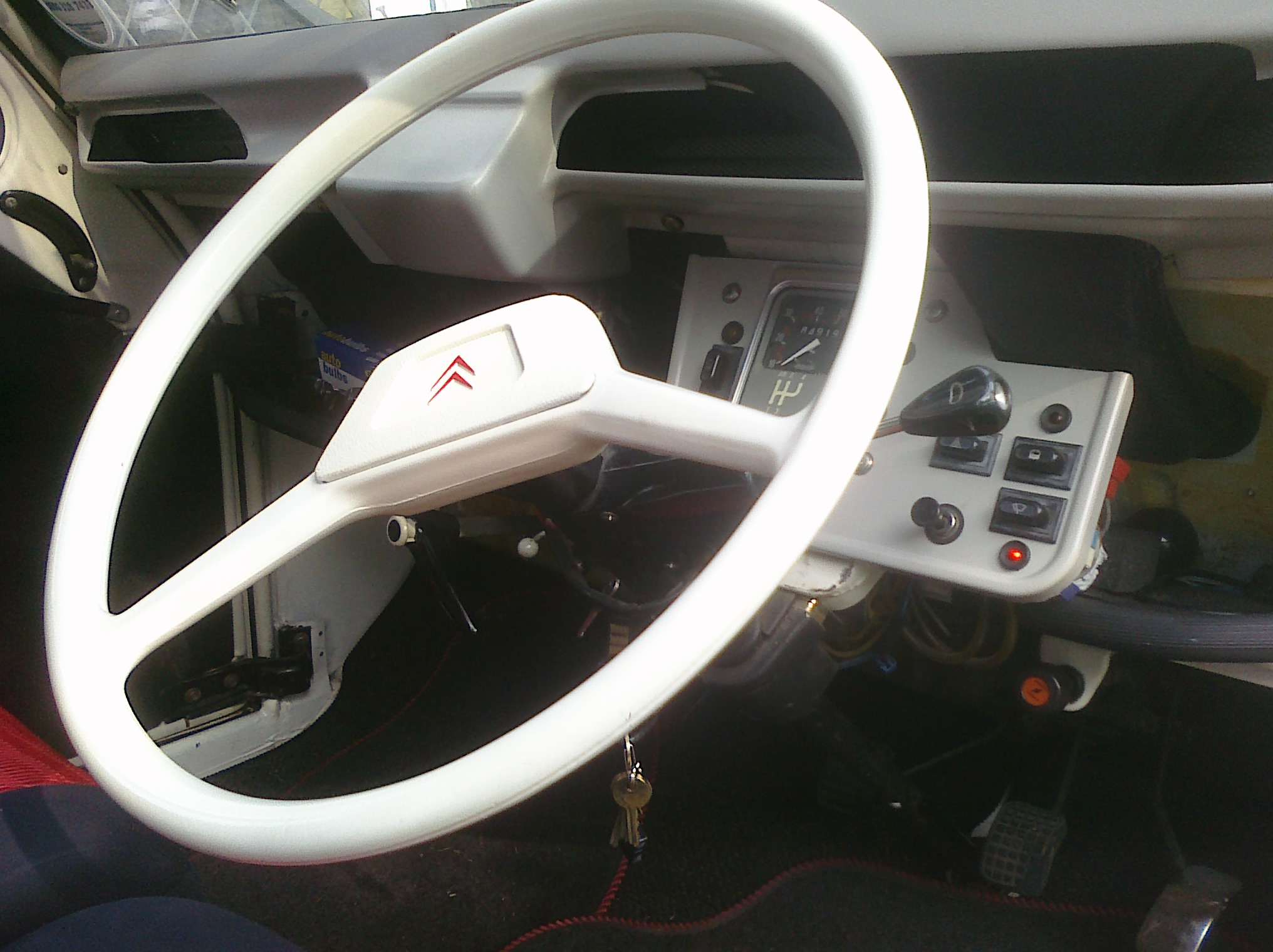

3. Replaced my speedo surround. I sprayed the new one in a sort of stone colour, to match the plastic heater/windscreen wiper cover, which I did a month or so ago. All looks v tasteful, especially with my Alpine white steering wheel. Speedo's ticking like a flippin sowing machine now though, so I guess I'll have to do some pesky adjustments... one day.
Here's my revamped cabin:

And here's a crappy image of the upper bulkhead trim design:
You won't be able to see details or dimensions here, but if you'd like a version just let me know and I'll PM you an image that you can work from or scale off... or if you prefer I'll send you a .dwg file (ie AutoCad format) for those who have access to cad software.

Post Re: Snowy the Snail
Oooooooh, that's gooooooooooood.
I can't get over how much better the light coloured interior trim looks compared to black.
