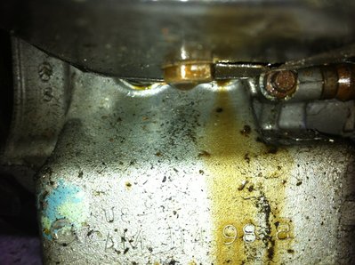

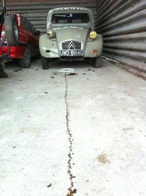

Although there's a slight oil leek :roll:

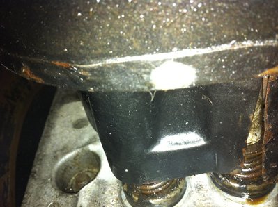

Caused by a leaking or maybe non existent push rod seal

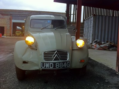

She's nice to drive.
Tested and working:
Clutch
Reverse, first, second and third gears
Breaks (will change the fluid though)
Break lights
Dip and full beam
Not working:
Horn (was, then stopped)
front right side light
rear left side light
indicators
Not yet tested:
Windscreen wipers
4th gear
I also need to find an air box that fits. Any ideas?

It looked proper french bouncing round the farmyard today. Sounds lovely too!
About the last job I did was to have the heads off to replace the pistons & barrels, so it's entirely feasible. I don't recall a leak, though - and I'd definitely have remembered THAT!
Not yet tested:
Windscreen wipers
Should be OK - I stripped the motor down, cleaned out and regreased the gearbox - which was full of, well, fossilised earwax...
4th gear
It's an old box. You need to go sideways from third, then all the way forward, not half way forward to neutral, then across and forward. When you come out of fourth, you have to go to third, not straight to neutral.
Oldie :-
Code:
R   2    4
|     |_____|
1    3
Normal :-
Code:
R   2    4
1    3
That one doesn't? Bugger. There's that horrible chrome pancake thing...
