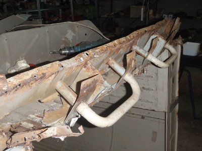

Hardly done anything today, bloody customers buying parts all the time :mrgreen:
Rotten piece of shit. Interesting design, I guess the guys at Citroen design dept. had too much red vine, when cooking up this cross bar
Janez over to you, I'm waiting for a new panel from your skilled hands. :mrgreen:

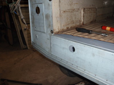

Post Re: Odin

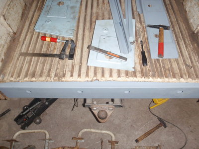

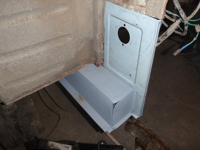

I made a AZU panels... now I have to send parcel to Viking. So, some pictures here ...
... inside view...
outside view...
... this one is assembled ... painted before on the inside...
... painted outside...
So, what is the verdict ? Is it OK...?

Post Re: Odin
Bloody good mate Image
November 13th, 2010, 11:37 pm
Post Re: Odin

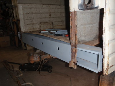

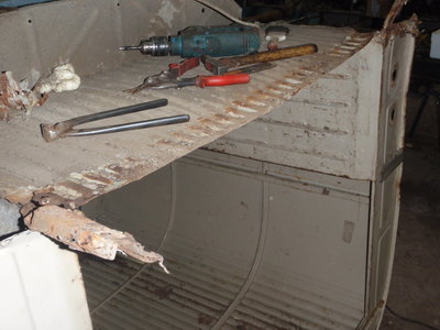

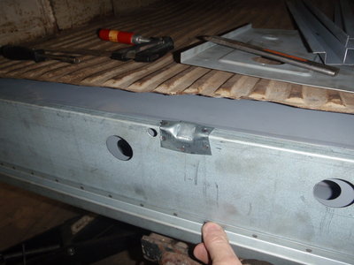

Time for a small update. Panels from Janez arrived, thanks heaps Janez, your panels are well made and spot on matching the measurements I gave you. Problem is that I did some minior mistakes, so I have to alter a few things. Not your fault at all, it is I not checking the numbers before sending them to you. When I get to it, I'll upload the correct measurements here should others need AZU rear cross box.
Thanks again for taking time making these panels and shipping them to me in France. Without your help, I would have been up shit creek without a paddle.
Cheers
Viking
