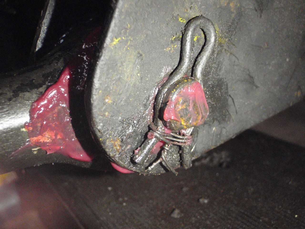

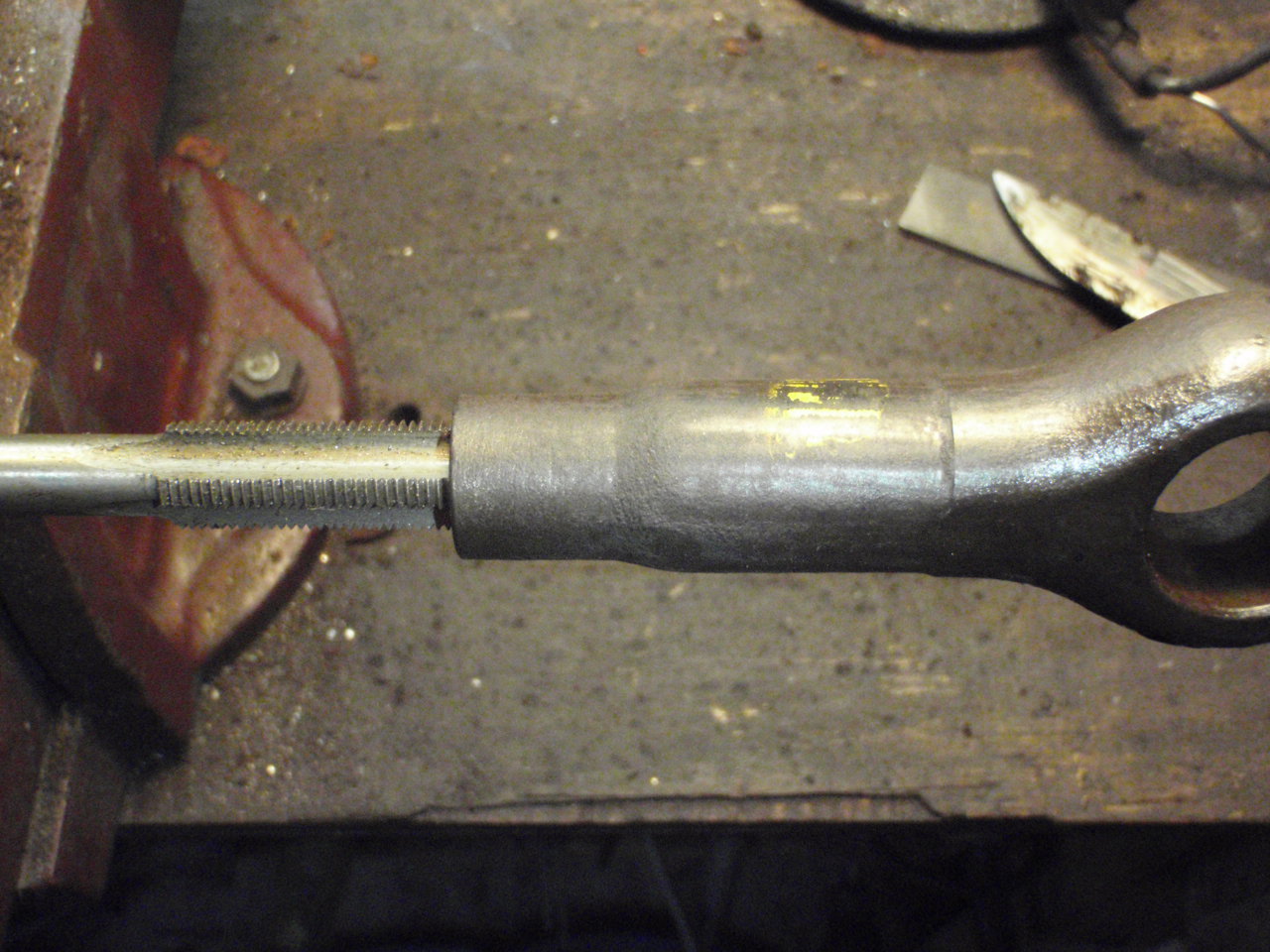

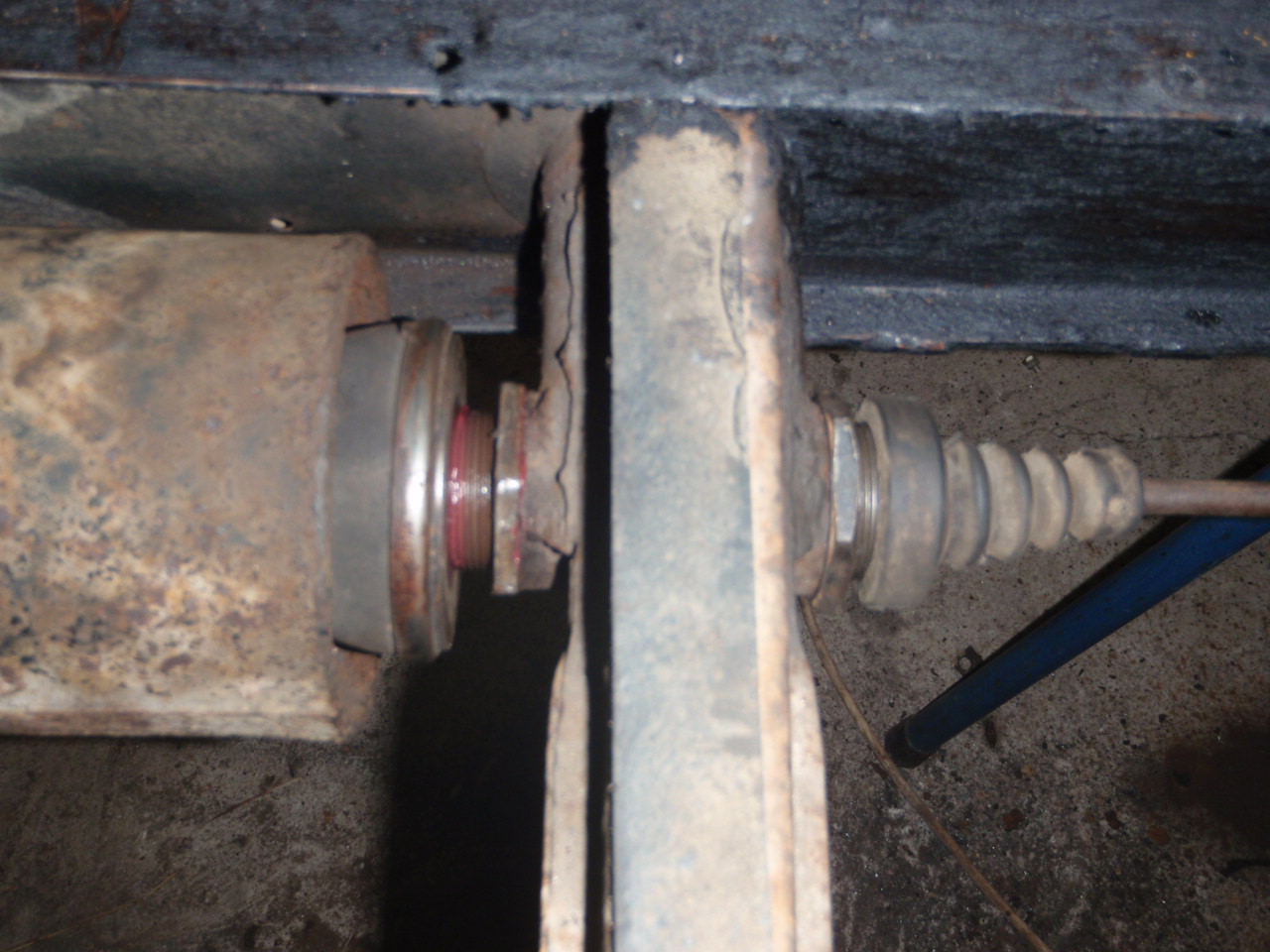

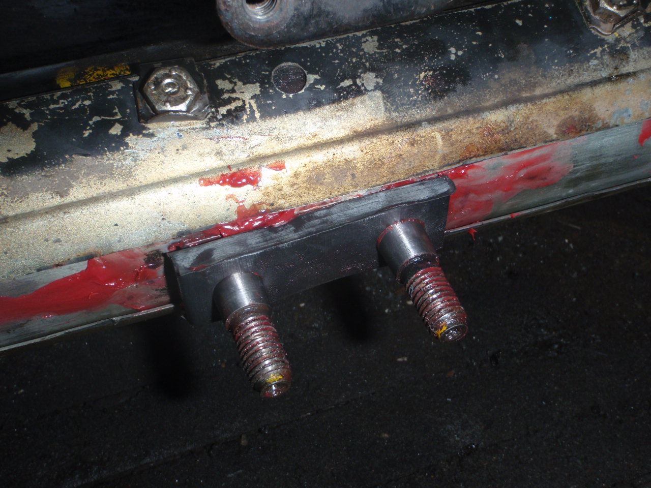

Finished all 4 swing arm bearings, cleaned and greased up. Fitted both spring pots and connected all tie rods, end eyes and knife edges. Clips secured with wire so I won't loose them on the raid if going through high grass or bushes.

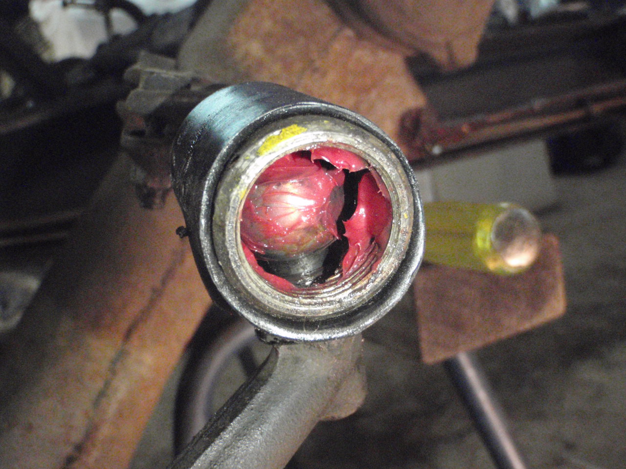

Moving on to the steering

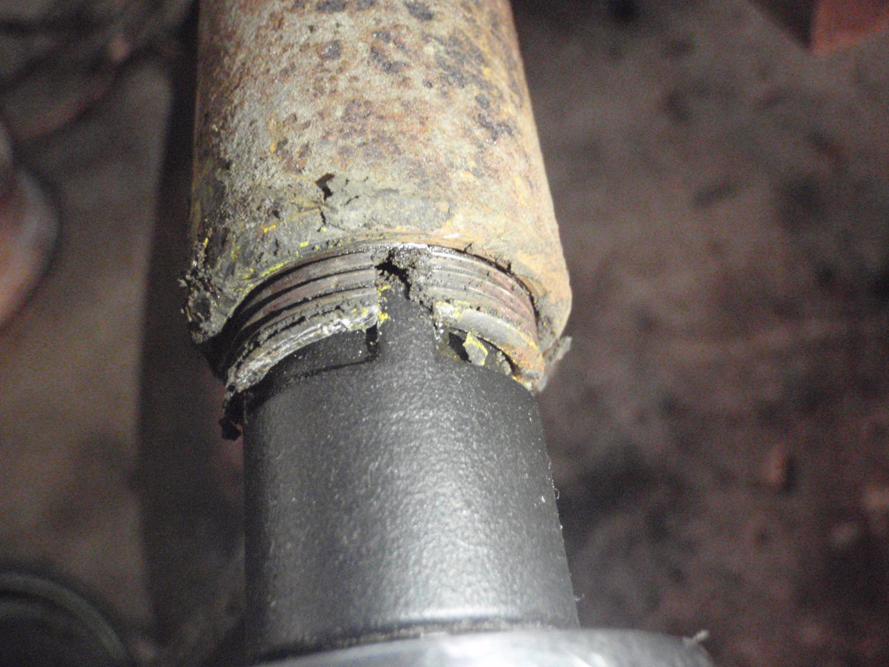

Track rod end housing and steering arm ball joints dry as bone + some minor chips to file away. Cleaned, greased and fitted again with new boots.

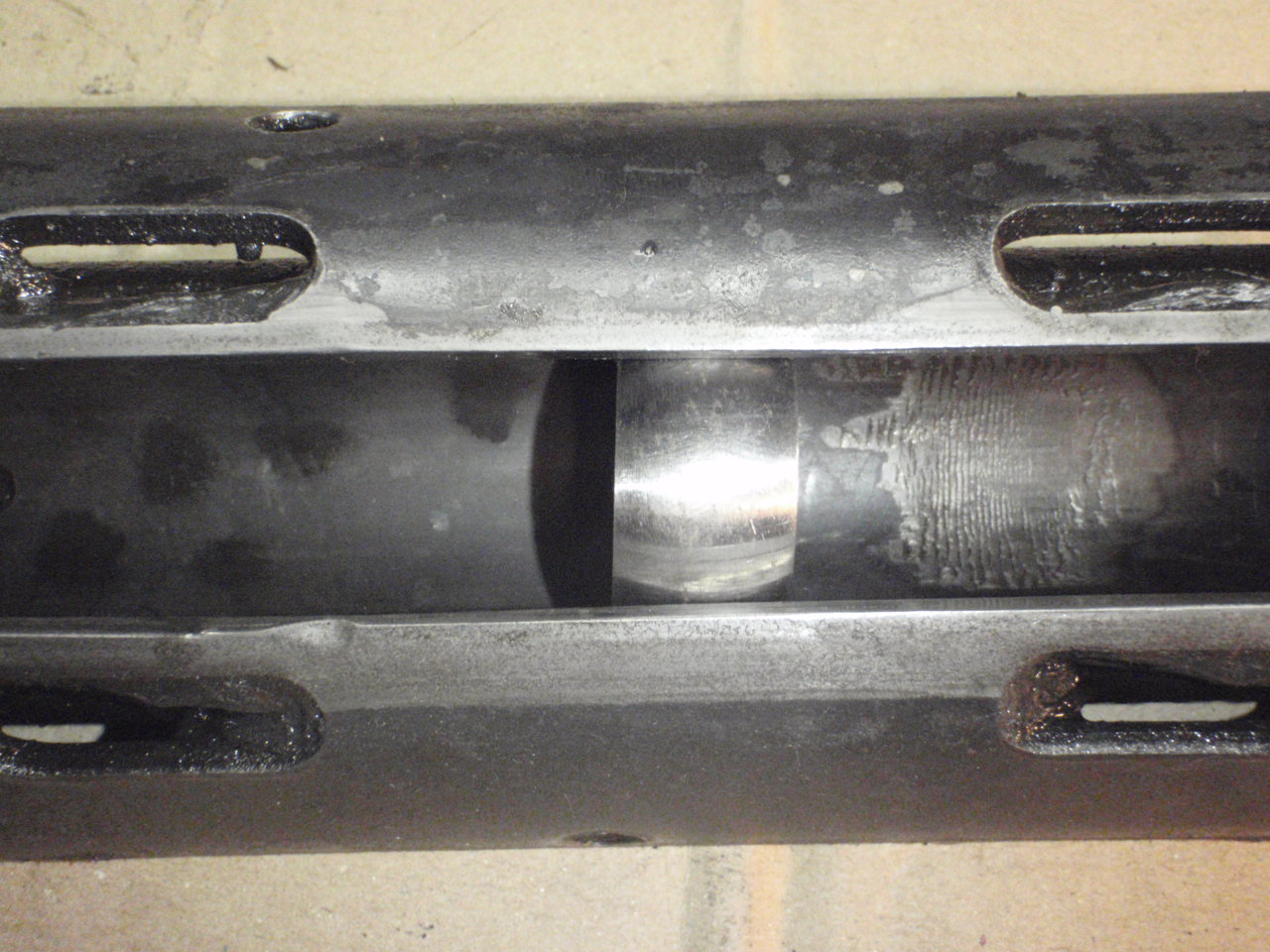

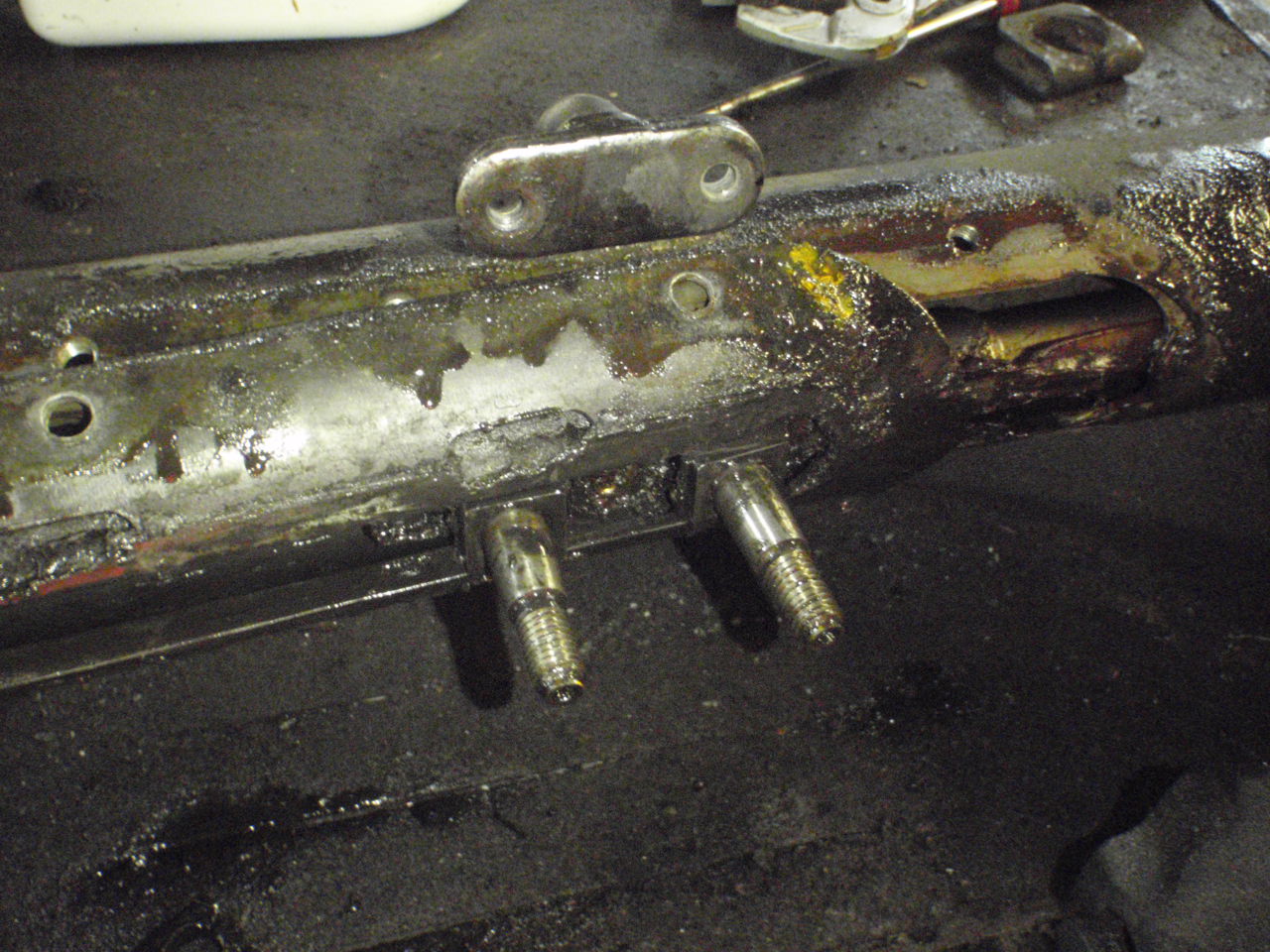

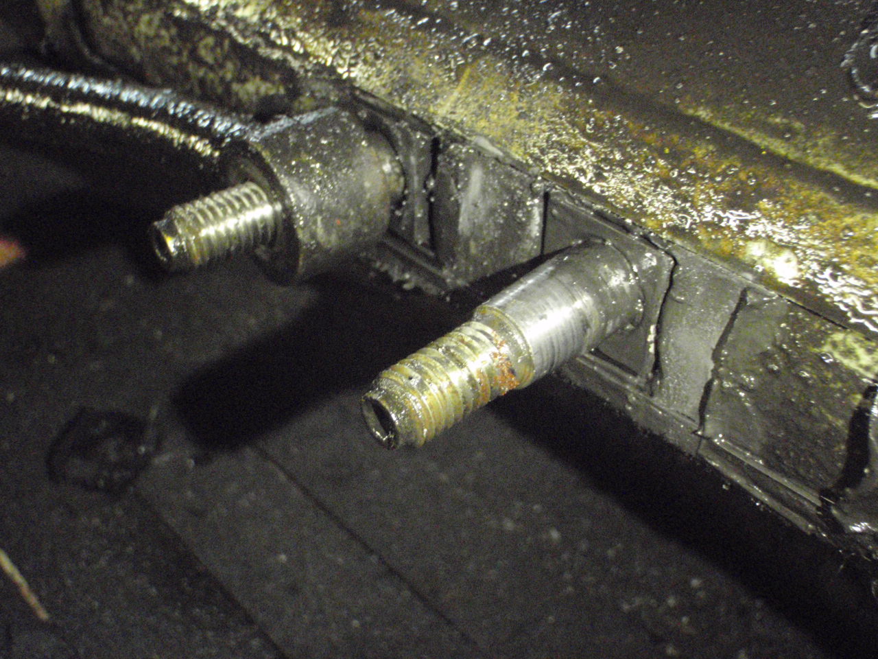

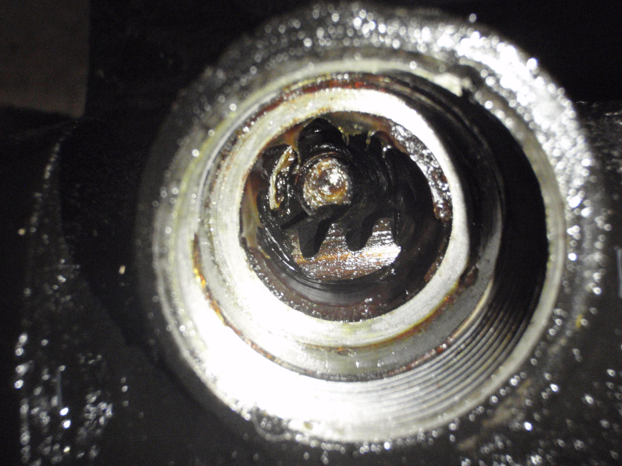

Last job today was stripping the steering rack for a good clean and regreasing.
Pinion bearing buggered.
Guide ring a bit worn.

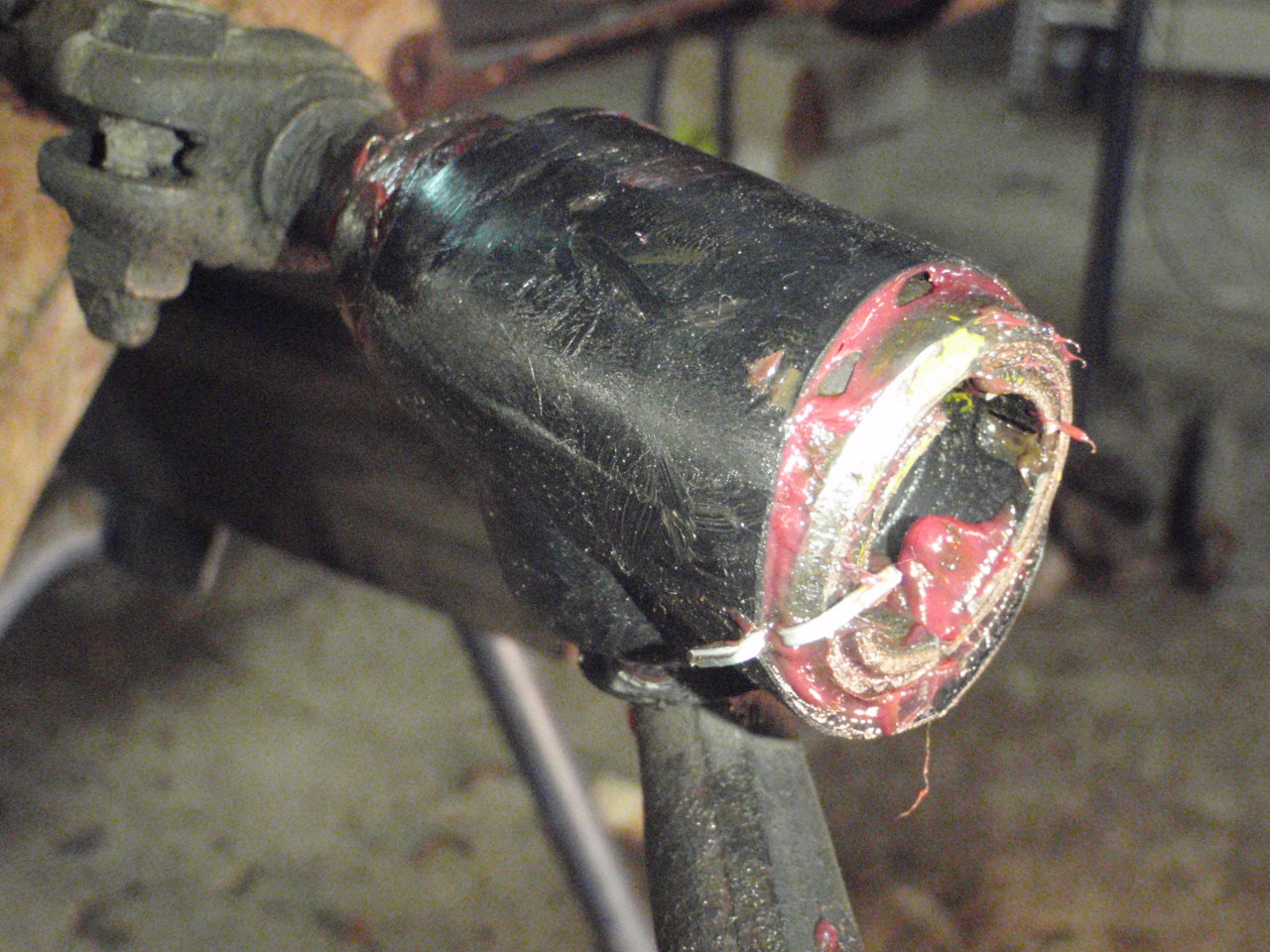

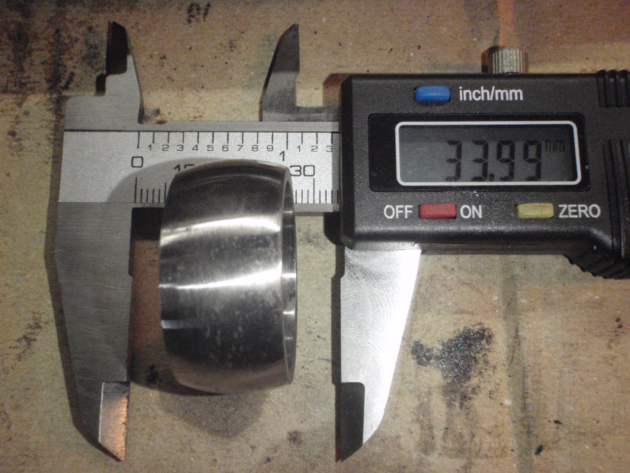

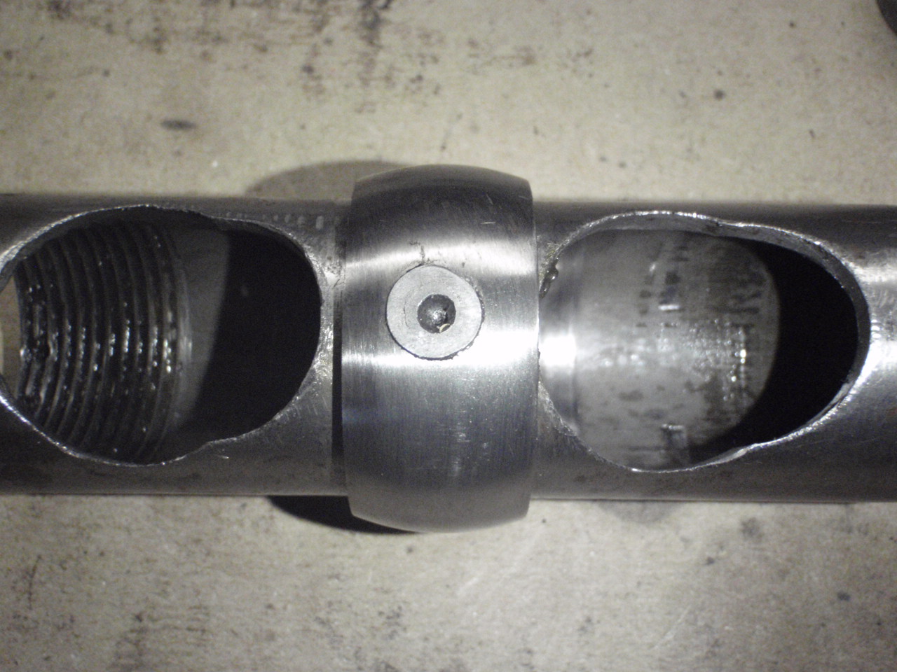

Finished the rack today. When time comes, I'll do a proper steering rack over haul. This will do for now
Removing the guide ring manily due to too much play between the ring and the guide. New ring is fitted tested inside the guide making sure it does not bite on the guide moving it from side to side

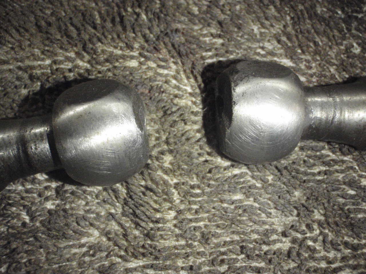

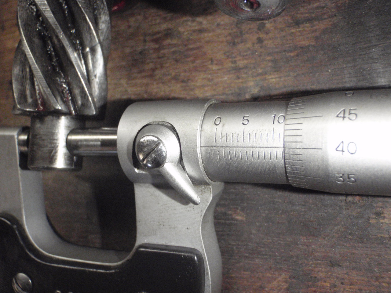

The new reproduction pinion is too big and is biting when fitted in it seat.

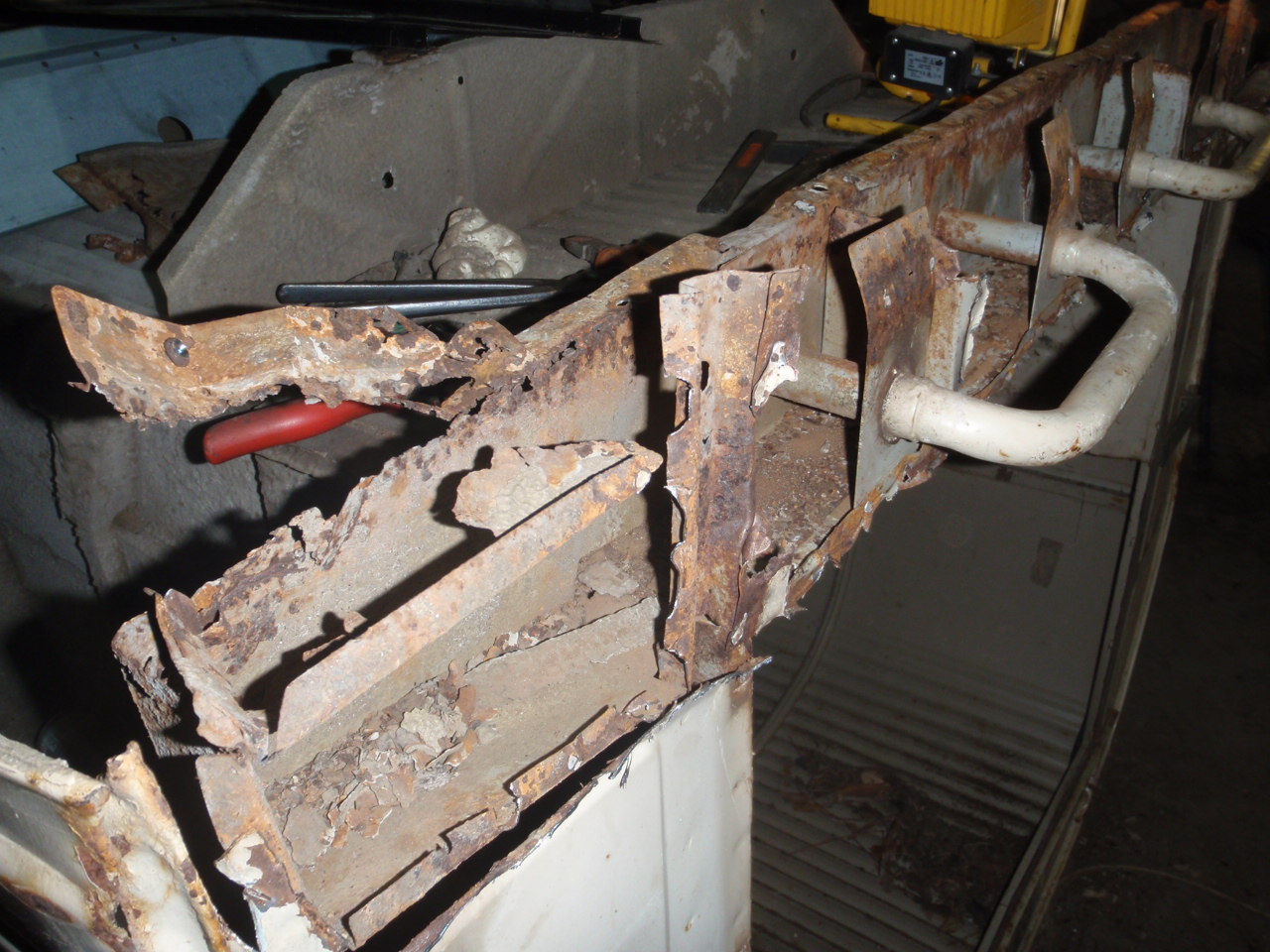

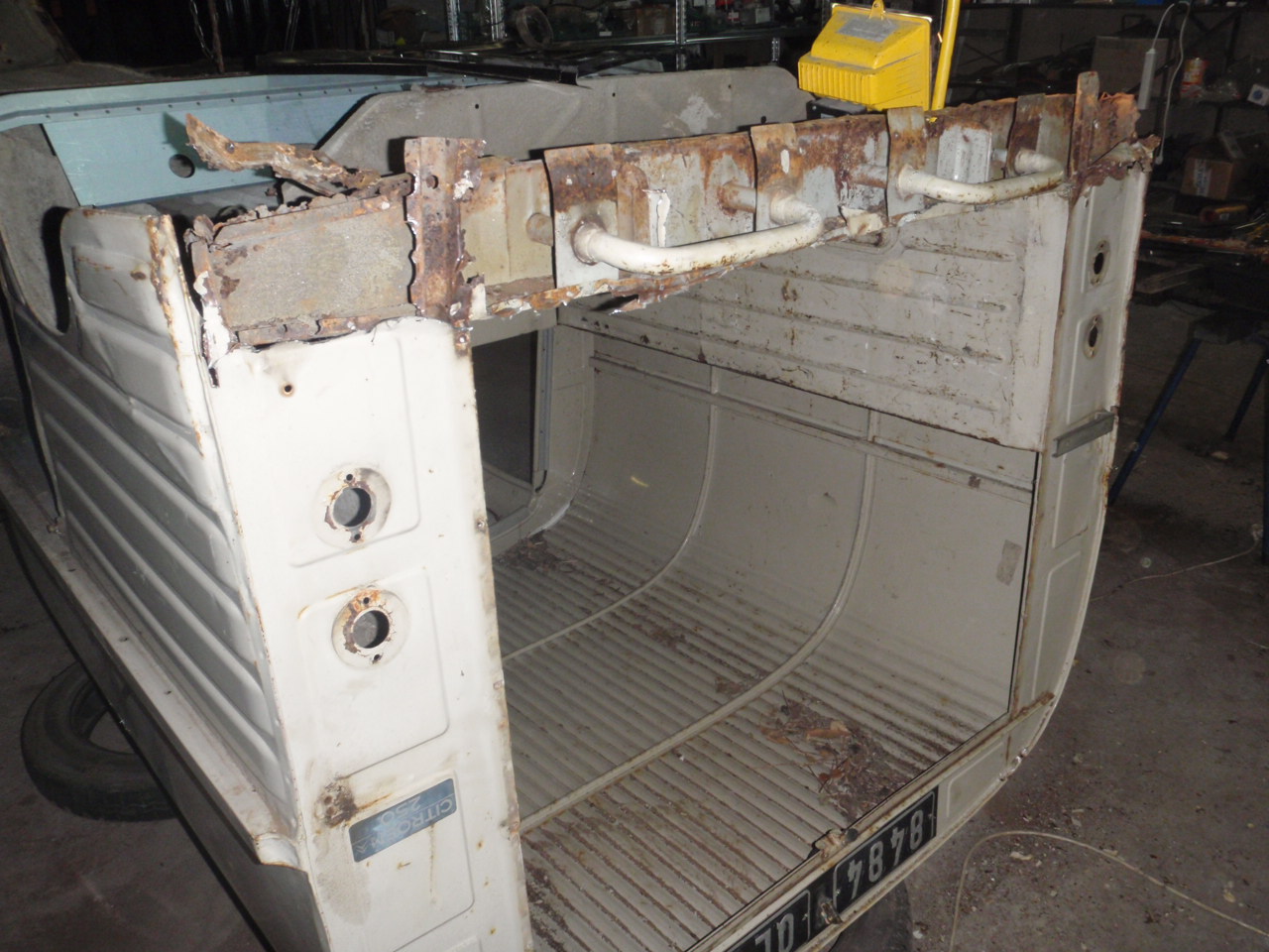

Body work, gives me a break from the mechanics
Not much need for text here, photos says it all.
Would like to ask is the rear cross box is available. If yes, great, please PM a price to France + postage.
