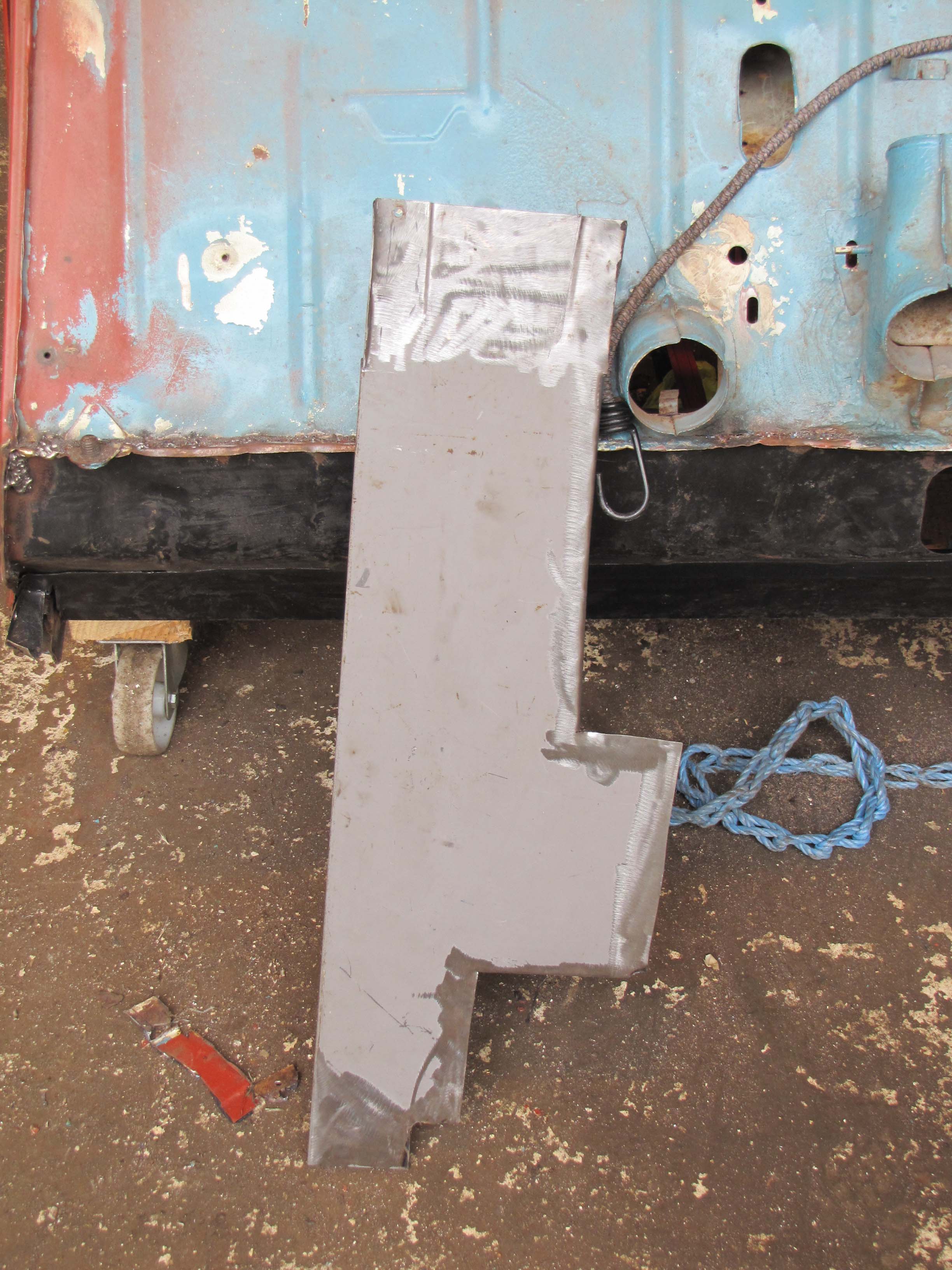

Weekend work on the body part 2 a
File comment: Cutout ready
File comment: This panel took quite a bit of fabricating
File comment: This is how it was done
File comment: The old and the new

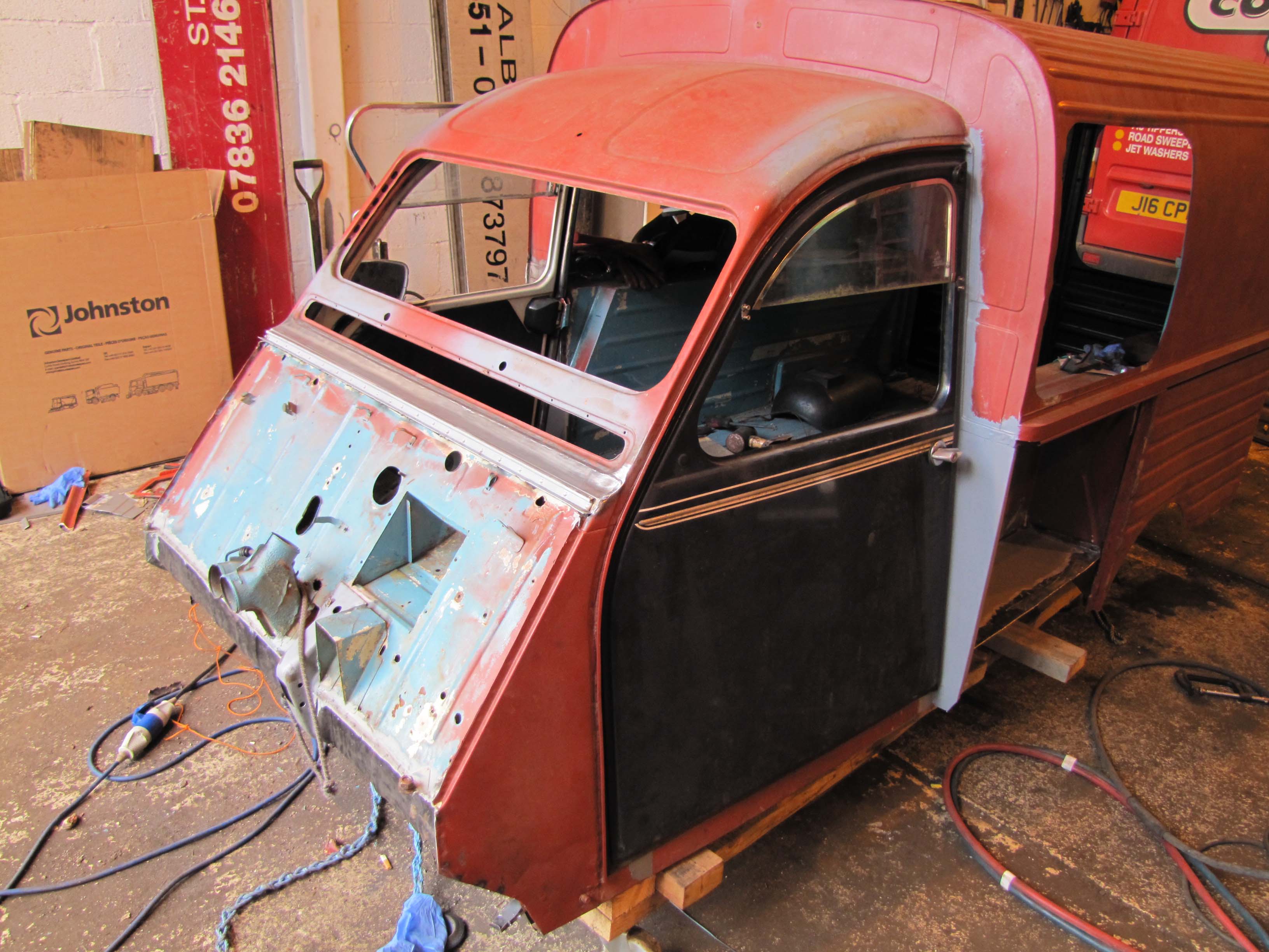

Weekend work on the body part 2 b
Heavy weekend but we seem to have made some real progress thanks to H and Russ hardwork with the welding. Thanks to you both.
Still got the rear cross member, the rear valance, the nearside rear panel and floor to sort when its home and back on the chassis.
Oh the chassis more on the work there later.
Bored yet?
File comment: Bonnet hinge tacked in
File comment: You cut out one bit and find some more work!
File comment: View inside from the petrol tank panel
File comment: A demon with the seam sealant. Shame he doesnt always wear the safety glasses when necessary.
File comment: Offside post ready for welding. A mixture of spot and butt welding
File comment: Drivers side panel and post completed. This door shuts like a dream. Great job from Harry and Russ
File comment: Bonnet hinge repair panel in and sorted
File comment: Second Battery shelf - first fit
File comment: Its a little bit high to work on !
File comment: Seam sealing the new metal underneath

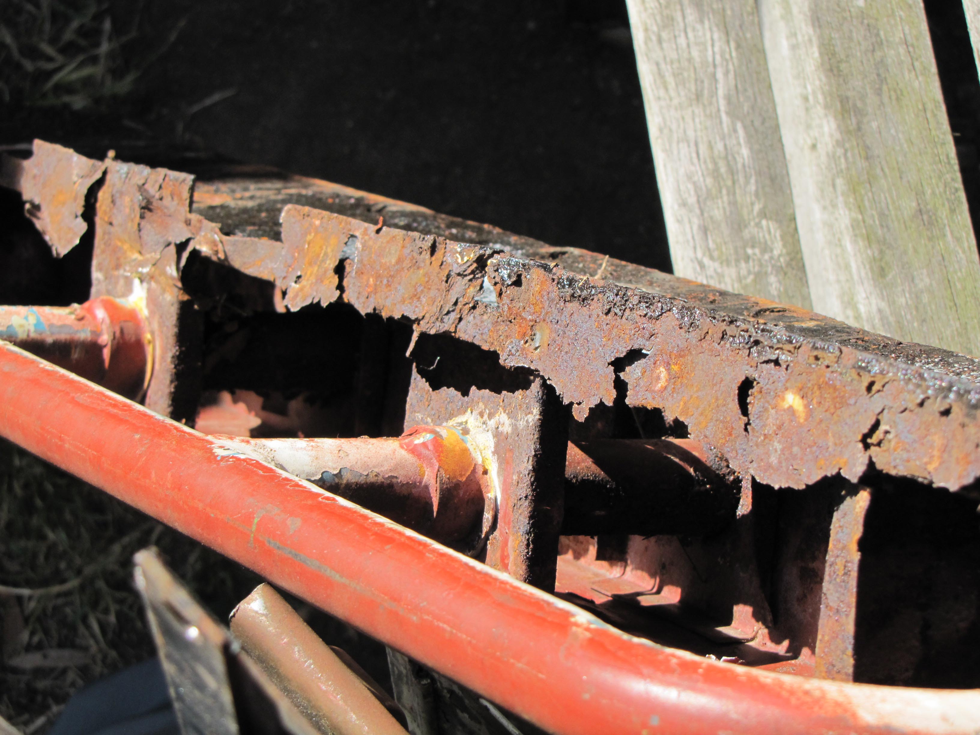

Ken
I found this amongst your pictures on Flicker
Where as Roy (ecas) as this as the way to fix this panel?
The Ecas picture allow for the front edge to be used to attach to the chassis doesnt it?
I am also interested to know how you have constructed the supports for the 'bumper' tubes. The original has a strenthener on each back and front and 2 cross supports which you dont show. Is that over kill by Citroen?
The ECAS way also allows the construction of the top section and the valance to put together off the vehicle and then after fixing allows the bottom L shape to be added it would seem to me?
Any views greatly appreciated.
July 10th, 2010, 11:34 pm
Post Re: AKS400 Pastis
Norman,
have added another pictures on Flickr...
John had bought the repair panels from SPOG and as there were no instructions provided, this was the only arrangement we could find in which they would fit.
There was no chance at all of it fitting as shown on Roy's picture.
Mind you, we had to take it apart and reassemble it with the top and bottom of the box not parallel, in order for it to sit correctly on the (Frome) chassis. These pictures are of that first (trial? ) fitting...
'Steadies' for the rear bumpers were made with tubes which were a push fit in the original items and these were welded into the front part of the box.
The box and rear valance were assembled into one unit, which was slid (read as 'hammered' ;) ) into position, then plug welded to the van floor. I welded some extra brackets to the front of the box to bolt it to the chassis.
