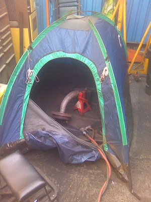

A blast cabinet would be nice, but I've nowhere to put one really, and I do tend to move around a lot so the less kit that I have to carry from house to house each time the better.
Here's my shot blasting unit ;)
