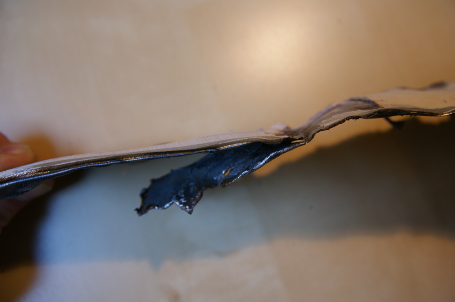

Went over to see the car today. The rear right sweep has been extracted. You can see that water has been getting in through the cracks, given the state of the tubular strengthening piece.
I'm so glad there's brand new metal going in here, it's what should have happened the first time around.
The old sweep was in a bit of a state. Apart from the layers and layers of filler, underneath it appears that the old damaged section of sweep was never cut away :? Instead, it was bent backwards, and a new peice of metal patched over the top. Surely it would have taken like 30 seconds with an angle grinder to strip the old damaged section away?
So the old damaged metal was happily rusting away under the new stuff.
:shock: The mind boggles at these bloody cowboys.
