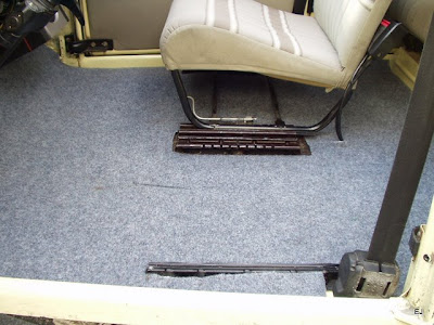

Carpet is a good idea. Just get one that doesn't absorb much water, is "breathing" and dries quick! I bought one designed for outdoor use, outside houses and on small boats. If you hold it up against the sky, you can see light through it, so no water is getting trapped under it. It dries up trough the carpet. It is also soft and nice for you're feet when driving barefoot! (I do that allot in summer 8-) )
Directly translated from the Norwegian word for this kind of carpet, we call it "Carpet grass" or "Balcony grass".
I recommend it!
But after I repaired rust under the windscreen-rubber, the car is 100% waterproof. Absolutely no water is getting in when driving or parked, so the floor and carpet is always dry anyway.
