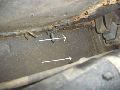

How to inspect the chassis.
2CV chassis are very good at hiding the rust. They are rusting from the inside and out, sometimes with no visible signs.
It can be very stressful to bend a chassis in the middle of nowhere and think that the car will be abandon. That is not going to happen. Check the chassis all over in particular here for a ripple. The side rail should be straight flat running your fingers along side the chassis. If you find a ripple don’t reinforce the side section. It simply can’t cope and is very likely to collapse during the raid. Fit a new good quality chassis and all your worries are gone.
If you see a gap here, the chassis is ''KAPUT''

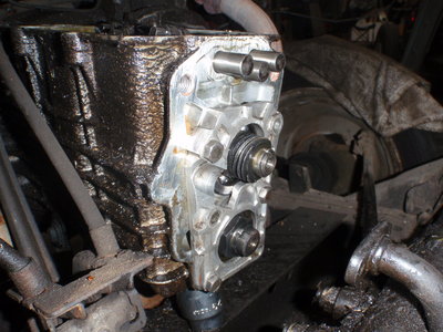

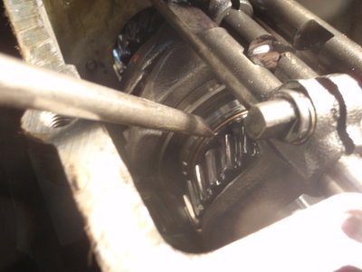

What to do on the gear box. Being bogged in sand is a potential recipe for disaster. It is very important to lock the selector ring on 2nd/3rd sliding pinion and to tie the 2 rear nuts behind the rear cover. If you don’t know how to, have it done by someone in the know.
Apart from that, look at your gear box mount, boot on the gear lever and the 2 rubbers on the lever joint.
Sand is a perfect killer of all metal, best kept away from the gear box. Make sure that the bash plate underneath doesn’t allow sand reaching the gear box and in particular the clutch.
Add fresh gear oil and bring same oil just in case you need to drop the oil.
