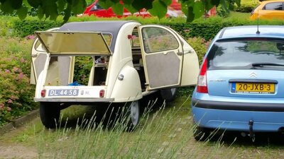

I had an moisture "eater" in the car but some times it toppled over and the dirty water was all over the floor. This water keeps attracting water. And after the last heavy rainstorm water came in at the highest point of the roof. Never had that. So today i pulled everything out. Washed the rubber mats with scrubber, dasty and water they were very filthy. The floor i washed with a rag very dirty also. And as there was some rust along the sills i pulled all the sealing out, brushed the lot, vacuumed it and let it dry. When dry i put primer/rustconvertor on it. I wanted to put the front bench in but did see one of the struts was broken. So welded it up. And just after putting everything back together a heavy rainstorm came in pfpf just in time ;-)

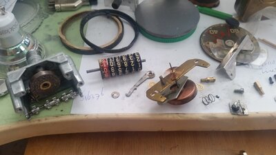

Did repair the 55's blocked speedo. Lucky for the owner i had a Veglia lying around. So i could mixe parts of the 2 to get one working.

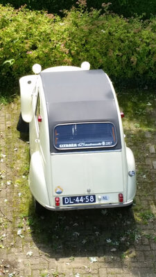

Was working on the roof, cleaning the solar panels. Made this pic from the deuche...
