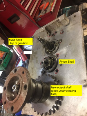

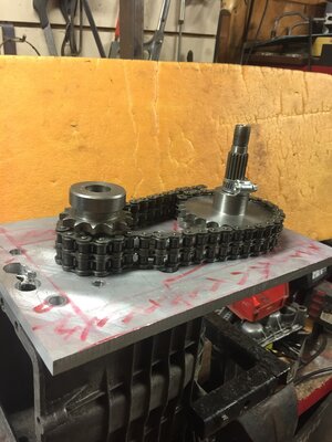

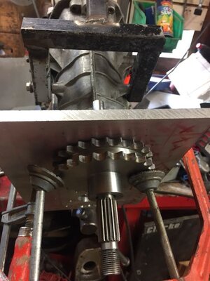

Post Transfer box.. A new version...
Any interest I will post more info.

With chain drive?

Chain drive isn't uncommon, some offroad-cars has them on transfer box. Range Rovers (not all), Land Cruisers, some American made...
Interested about? Yes, a lot. Like to see the build photos...
Have been thinking how to make a transfer box with centre diff. Liked very much of "three diff transmission" at six years saga with couple of Range's, and still don't like the Land Rover Series transferbox without centre diff. Have some sketch, but no real solution to make yet... Full time 4wd is what I like, especially with manual diff lock on centre diff, with viscous wasn't same at all...
October 23rd, 2023, 10:11 pm
Using industrial duplex chain, 08B size, Looked at automotive “Silent chain” but can’t get the ratios, and new parts are very expensive.
Will have a step down ratio (13:25) and dog clutch at the gearbox end,
Rear cut down Diff / prop always connected.
Waiting on some “alu” plate at the moment.
Will post some more pics…..
Cheers
Peter

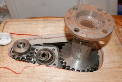

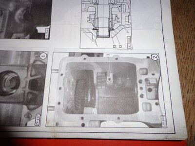

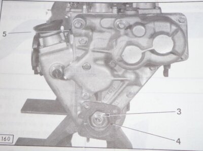

Why don't you use the output shaft, to hook you chain to, like a mehari 4x4 does to. Much less power evaporates and you can directly connect to your reardiff what you already have made.
October 28th, 2023, 5:10 pm
Hi Lpgo,
The Steering rack is in the way!
See Mehari documentation, extra gear and shaft below the pinion shaft.

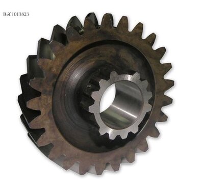

ps
The Mehari 4x4 special gear and shaft etc are available at about €2000+

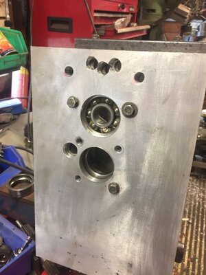

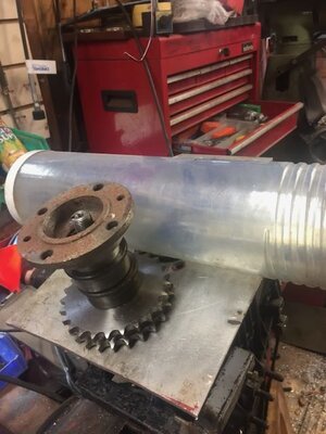

Back cover machined, fits well and retains the bearings properly. now to fit the extra shaft housing.

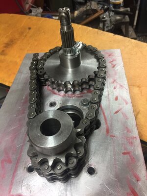

Chain arrived , try out for clearances and a rear cover.
