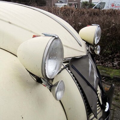

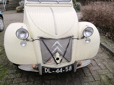

The city lights of the old 2cv are right misirable. Two tube bulbs behind the main reflectors. A slit in the bulb leaves a very small bit of light through. So i put 2 small bicycle lamps under the headlamps. Now the car is good visible.

Have the same problem with the 6v lighting of my 1932 Morris Minor. I've fitted two red LED cycle lights on the rear, but I'm struggling to find something decent for the front of the car. Ultimately the best route would be to fit LED headlamp bulbs designed for use in a vintage car headlamp, but they're bloody expensive.

Good connectors, and extra mass connections might solve the problem. A friend had his 1959 2cv headlights failing the MOT test in Belgium. He did put in 2 heavy duty relais that take the power directly from the battery to each headlight. They were as bright as halogen lamps afterwards...

Well the new lamps are great but as i mounted them upside down water can get in there. I did see they were half filled with water. So back to the drawing board... ;-)
