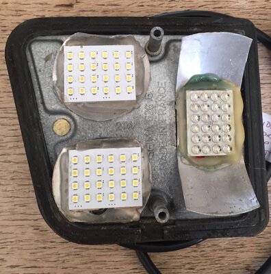

LED rear lights.
Parts on ebay, but cheaper if you use Aliexpress and wait...

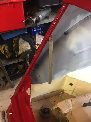

Found the boot stay..

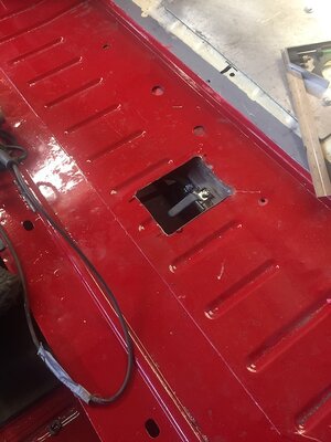

Change over fuel tap (under rear seat) for additional fuel tank.

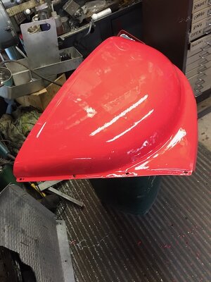

Craftmaster Under Coat on rear wing (with runs).

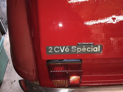

Essential extra Badge.

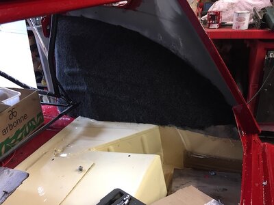

Carpet Lining on rear wing.

That's coming along nicely Pete. :)
I like the idea of the light conversion. :D
Can you still see the lights from anywhere that is not directly behind?
July 30th, 2022, 10:22 am
Post Re: EPB Refurb
Bulbs being a point source are the best option. the LED replacments are expensive.
The LED arrays are brigher and the Fresel Lens cover does its job.
See photo

Cheers
ps They work under water!

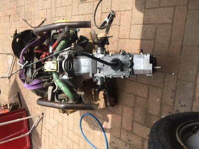

Engine and Gearbox ready to refit.

Cool :D
Though have to say I really liked the purple... then realised it was the lifting harness!!
