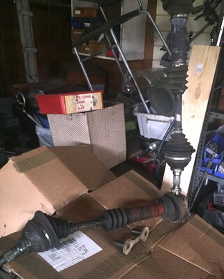

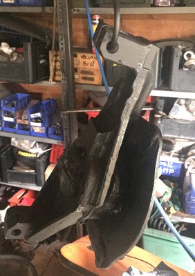

Hi All, Out of Hibernation and with no risk of Frostbite back to cleaning, painting hubs/driveshafts and new Gators. Like squirrel where did I conceal all the parts? Attachment:

subarupete wrote: Like squirrel where did I conceal all the parts? I know that feeling. Really, can't understand how much can be forgotten, but in the other hand, a lot of great surprises comes when "finding" all the stuff again what wasn't remember even seen before, butwhen seeing again just recall "i must have seen them before, some day"... Waiting to see what will become of these, and rest of the parts...

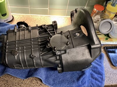

Gearbox after Vapour Blasting. Now just to reassemble it! Attachment:

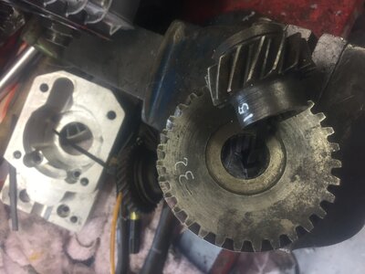

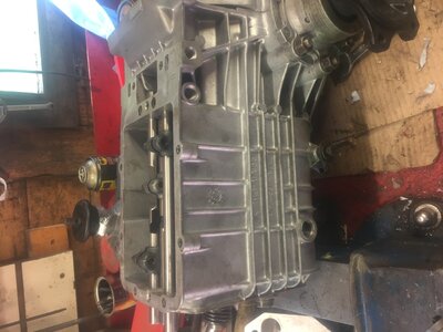

Last stages of gearbox assembly,  only to notice it has the incorrect 3rd gear in situ! Now to disassemble…reassemble again, but now I know where all the bits go. . Attachment:

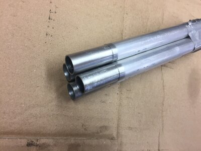

When the cylinder heads are machined for the larger bore barrels the push rod tube have to be cut out… Spent £18 on some tube and 1 hour on the lathe to make 4… Attachment:
