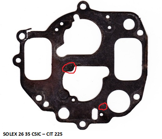

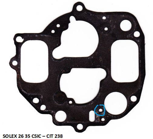

Post 2CV6 - Solex 26 35

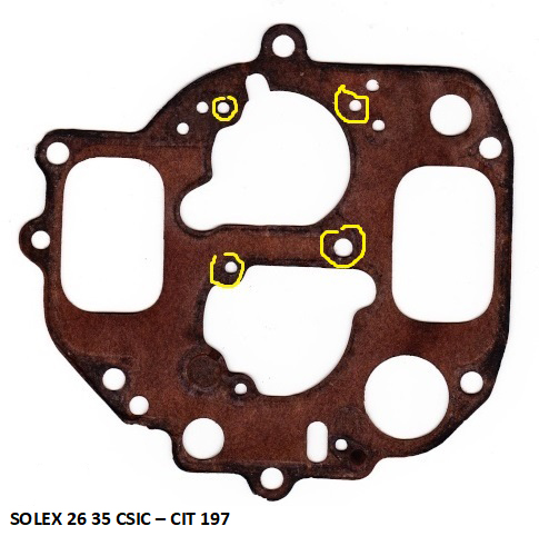

Hello
Identifying the right Solex 26 35 carb repair kit on the Internet is not easy .
I understand that there are different carburettor versions with different fuel gaskets depending on the CIT codes and CSIC / SCIC codes :
- CSIC or SCIC according to mechanical or centrifugal clutch;
and :
-- CIT 197 CSIC Mechanical Clutch (1978, 2CV6 602cm3),
---CIT 198 SCIC Centrifugal Clutch (1978, 2CV6 602cm3),
---CIT 225 CSIC Mechanical Clutch (1981 to 1990, 2CV6 602cm3),
---CIT 238 CSIC Mechanical Clutch (VISA 652cm3)
For our 1987 2cv6 with mechanical clutch the CIT code should therefore be 225 .
I have not found proper documentation on the different versions of gaskets
so below is the result of my investigations .
Thanks for correcting me
MG

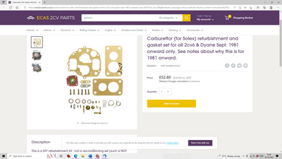

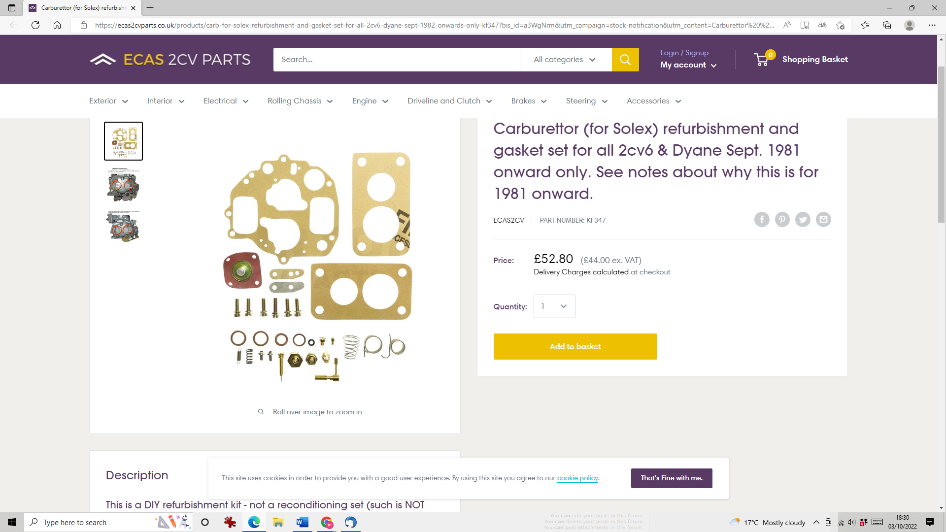

For information
The ECAS Solex refurbishment kit for 2CV6 which has been unavailable for several months has just arrived !
MG .

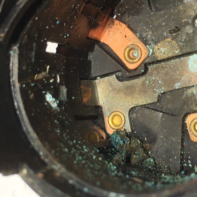

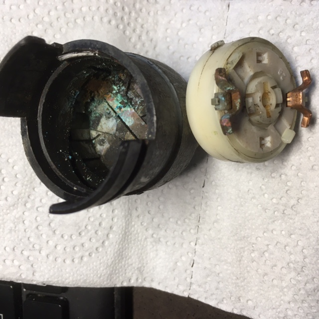

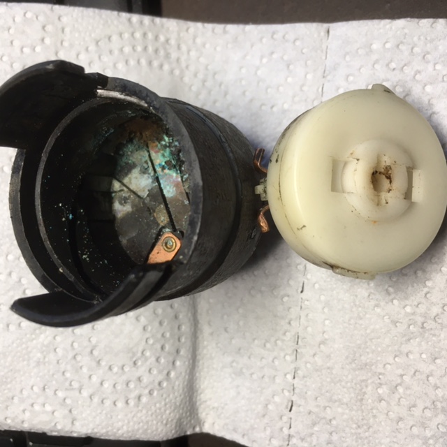

Hello
My friend's 2CV6 has been running well for several months since the installation of a good fuel filter.
However the other day it refused to start because no power to the ignition
/ faulty switch under the Neiman key lock
Fortunately replacements are available from Ecas who warns " Buy this new part but please fix your water leaks to prevent failure again. "
Indeed when opening the switch, there was huge corrosion inside , apparently from winsdhield water fluid .
Note that if you open the switch , it is not possible to put it back together ( without special tools )
Thanks to Fer for his advice !
MG
February 25th, 2023, 7:56 pm
Posts: 2303
Post Re: New with AZ 56
You can put it together michel. It's a bit fiddly but it's possible. Put the oxydised parts in vinegar with a few spoons of salt. It will get clean. Only rinse it good afterwards.
