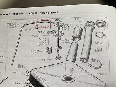

Hello Fer
Alas ;The little hatch is not big enough to reach the other end of the bit of rubber pipe !
You wrote :
If the rubber grommit (A175-9 ?)
is taken of you can take the filler pipe (A175-4 ?)
out trough the hole in the wing if the car is lifted high enough.
Why "if the car is lifted high enough " ?
Best regards
MG
May 15th, 2022, 10:41 am
Posts: 2303
Post Re: New with AZ 56
Because you will have to have some space to tilt the tank to get the filler tube over the chassis arm. Best not take the hose between tank and filler tube off. Mine was rock hard so in my wisdom i cut it off. It was very hard to find a fitting replacement hose, the modern ones are different size. And even that replacement hose took a lot of work to force it on tank and the tube...
