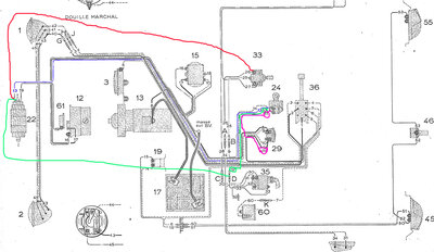

Thanks for your suggestions!
It cannot be the capacitor because it works when i switch on the back up feed ( red ) from the parking light switch.
... cable 11 ( purple ) from ammeter to ignition switch ? this is possible as i have not checked on the ammeter side . Good idea , Fer !
In the meantime , i have installed a new cable ( green ) duplicating cable 13 :
It comes from cable 12 also coming from the ignition switch and goes to the coil .
If this latter one works when cable 13 ( blue ) fails , this will prove that cable 13 is faulty.
Someone said that this was the simplest car in the world !

... An additional consideration :
In order to monitor the current flowing ( or not ) in the different cables , I have installed LEDs on the 3 cables to the coil :
- original cable 13 ( blue ) coming from Ignition switch
- additional cable ( green ) connected to Ignition switch via cable 12
- additional cable( red ) connected from parking switch 26 ( current coming from battery via cable 8 and 9 )
I have noticed that the first two LEDs are flickering a low rpm ( up to approx 1500 rpm ) ... as if the current was not continuous .
However , when the parking switch is switched on the 3rd Led is not flickering .
The only difference between the first two cases and the third one is that the current goes through the ammeter .
Although the ammeter is a very simple instrument , maybe there is something wrong with it :?:

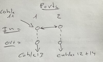

Hello Fer
yes , i opened the ignition switch.
it was in very good condition.I cleaned it .
I connected cable 11 to Port 1 "in "
....................cable 13 to Port 1 " out "
....................cables 12 and 14 to Port 2 "out"
.....................Port 1 "in " to Port 2"in"
I believe the ignition switch is OK
Although the current is flickering at low rev, it seems to run ok with cable 13 ( blue ) disabled and replaced by additional cable 12 ( green ).

Post Re: New with AZ 56
About the flickering , a reason could be that cable 11 ( purple ) going from ammeter to ignition key is connected on the ammeter to cable 10 (orange) feeding current from the regulator.
On my car, the regulator was faulty and i replaced it with an electronic regulator from Cipere which works well.
However it is possible that , for some reason, this electronic device is transforming the continuous direct current from the dynamo into a non-continuous current.!?
In any case this does not explain why from time to time cable 13 feeding the coil is temporarily failing
