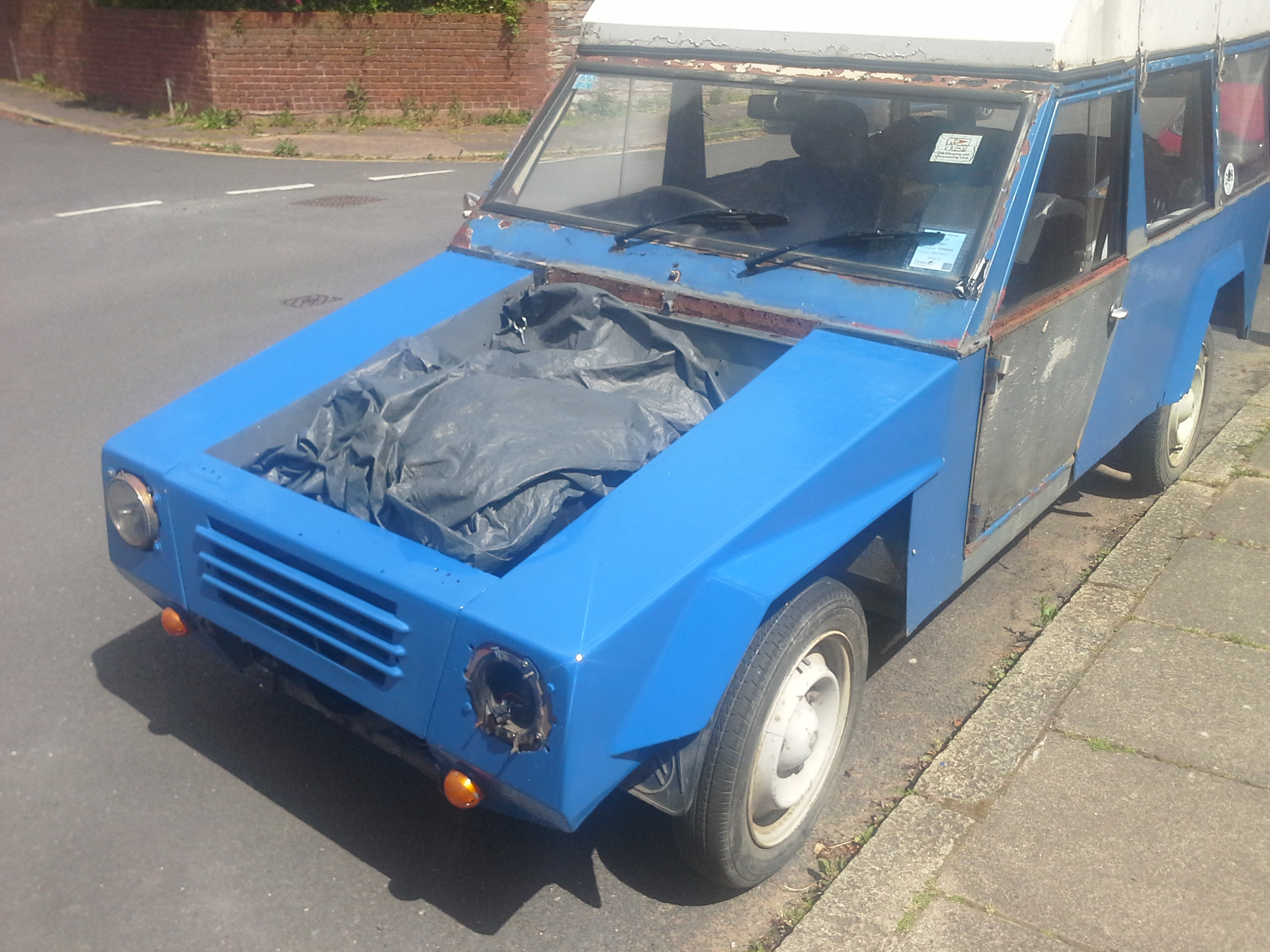

Post Re: My Beduino
Starting to get the front end together. :)
