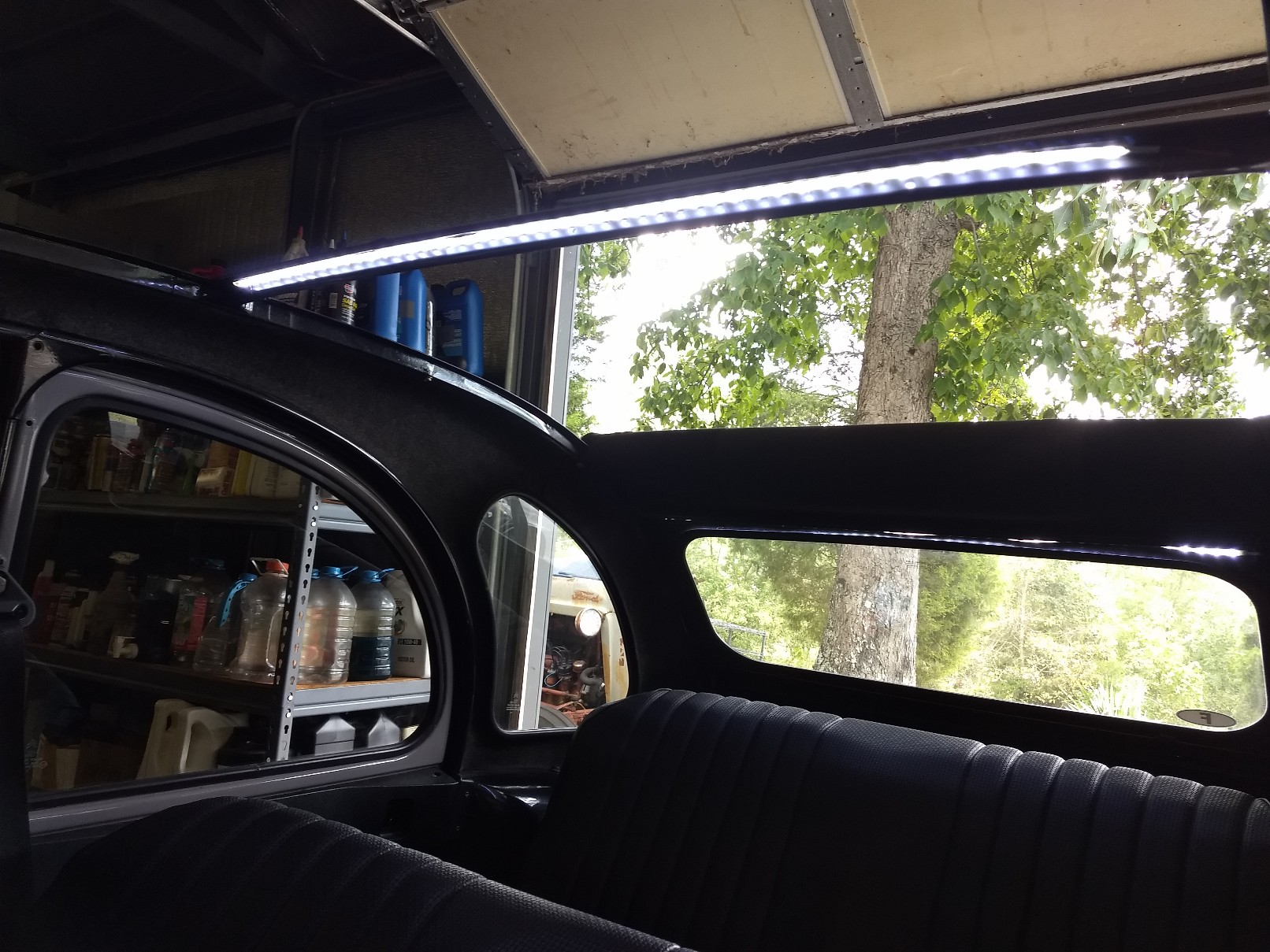

After troubleshooting that interior light (which was a poor earth all along), I decided to modify the interior lights. The switch broke eventually anyway.
I bought some of those LED strips and cut them down to about 1 meter. I got one above the front seat and one in the rear.
Then used one of those burglar alarm reed switch to trigger the lights. I used 3M sticky tape on both sides.
The LED strips fit well to the support beams but it would be nice if the switch didn't look as conspicuous but it seems to work and puts out better light. That's the only way I could figure out where to mount the switch to trigger the lights.

Before I wired in the Reed switch, I accidentally left the wires plugged up and they lights were on for 12 hours and never ran the battery down.

Snapped a photo of the interior this morning in the parking lot before heading into work. This was a little after 6 am before the sun came up. These LED strips put out more light than modern cars with a center mounted dome light.
