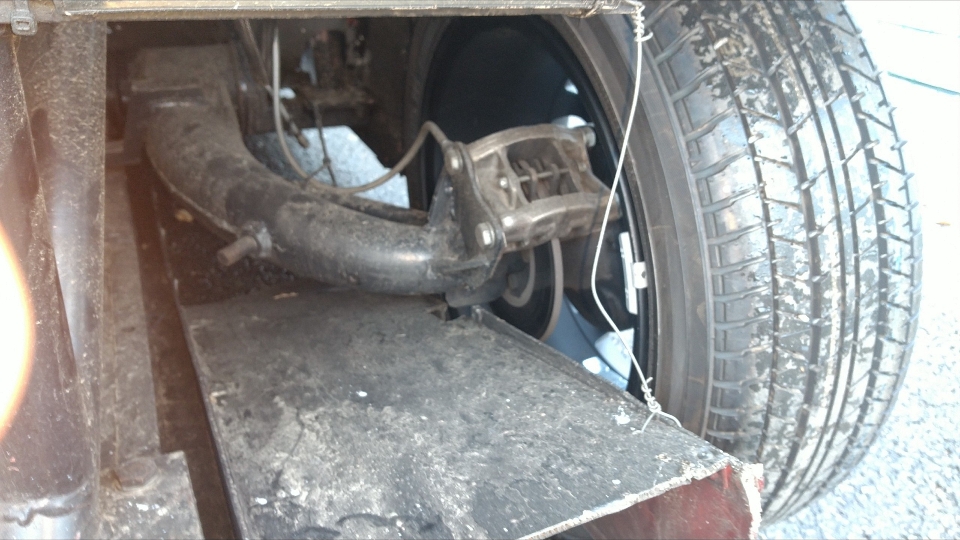

Would GS rear discs fit on 2cv arms?

Post Re: Rear Disc Brakes
Here you go, its a pain in the ass doing this on my phone.. This evening more..
Gs Bx Xantia C5 all will do..
June 1st, 2019, 1:47 pm

One solution from Finland. GS wheel hubs/discs, Xantia calipers...
Yes, some little metalwork needed, the axle shaft is same diameter etc...
