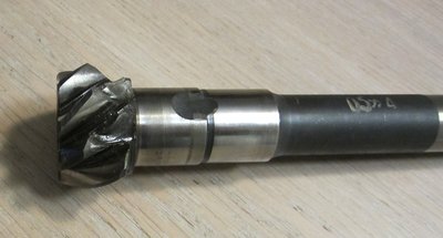

I am disassembling the broken gearbox. A few parts are still ok. Here the cuplrit of it all. The pignon did loose some 5 half theeth... and one af them fell between the gears..

Post Re: AZL 1957
Wow! What would cause that?
