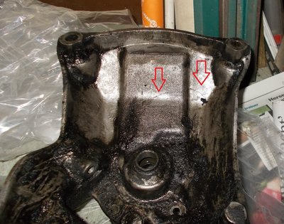

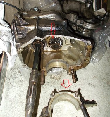

Took the gearbox apart. It is completly dead. The pignon did loose an half tooth, that must have dropped between the teeth of the crownwheel. Than it had the loud bang and lost 2 more half theeth of the pignon. The force between the teeth did crack the aluminum box that was just hold together by the brake flanges..... See the pics.

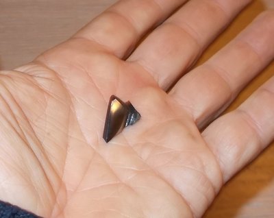

Geo gave me the ex-gearbox form his BMW deuche (Une grande merci). I already cleaned the outside a bit with a scraper and a vacuumcleaner!! The old grease on that gearbox was very dry. Here one of the teeth from the gearbox. Incredible that such a small piece of metal can destroy an complete gearbox. I didn't see something yet that could have been catched in the gears. The bearing from the pignon has a bit of play but that could also have been caused by the "accident".
The piece acts like a lever, and really can destroy castings. Also the casting can be very brittle after decades of use...
If you are using parts from that exploded box, clean them very carefully, to have all metal chirps out...
