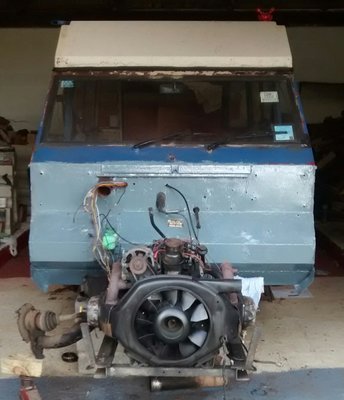

Post Re: My Beduino
File comment: Applied some top coat to the bulkhead to day
August 30th, 2018, 9:29 pm

In amongst all the other things I haven't finished yet, I'm thinking of making a mechanism to enable me to tip the whole wings/bonnet section forward. I'm looking for ideas into a quick release mechanism for the with GS to body area. :)

The hinge and joining panels I'm ok with. Its a quick release for opening the bonnet I'm having trouble visualising.
Currently, each wing is attached to the bulkhead with 4 nuts and bolts. You can see the holes in the last image.
