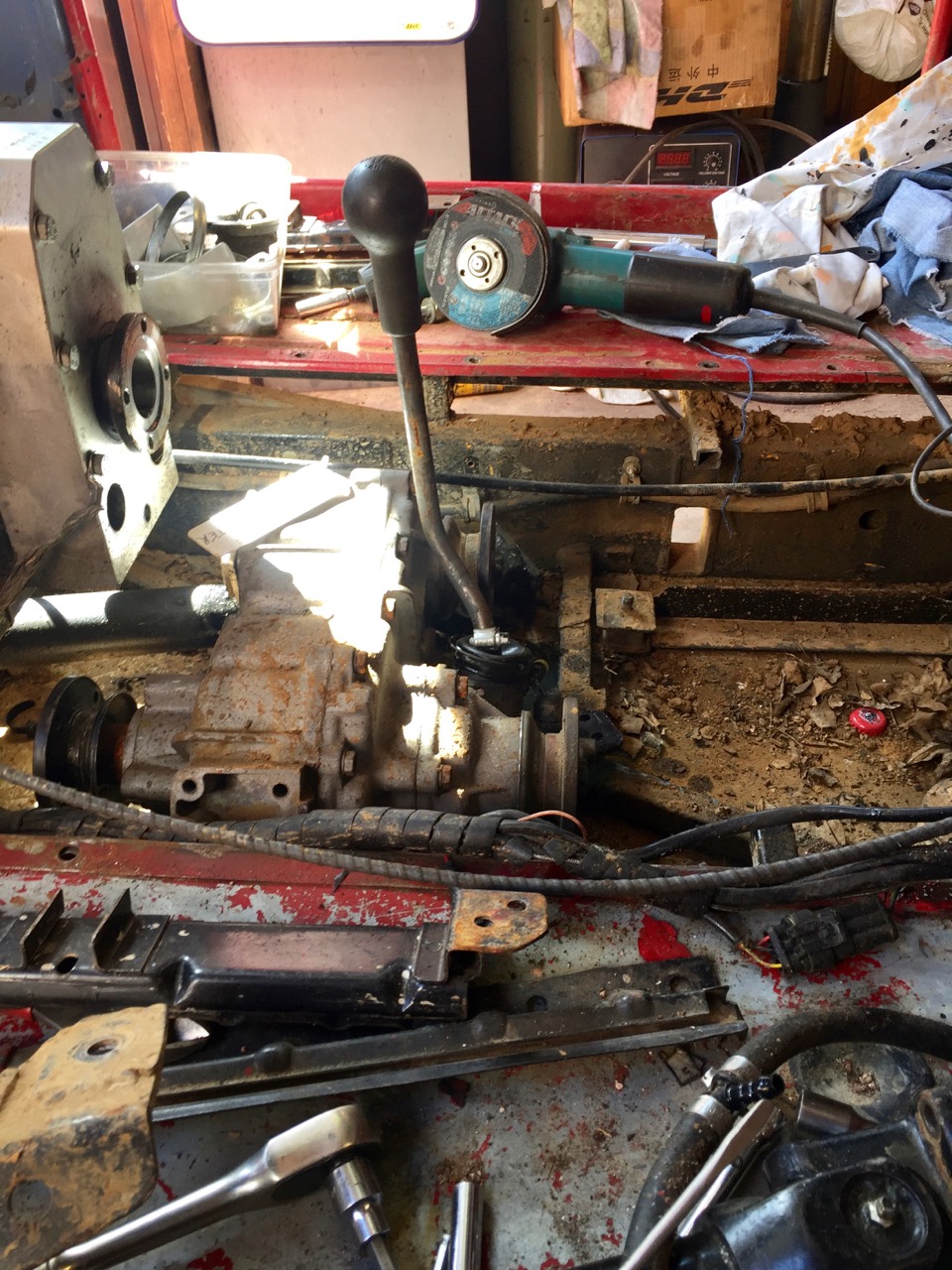

Current position for Transfer Box.
New Position for Transfer Box turned thru 180deg.
(Note the gbox on the middle left wont be there.)
