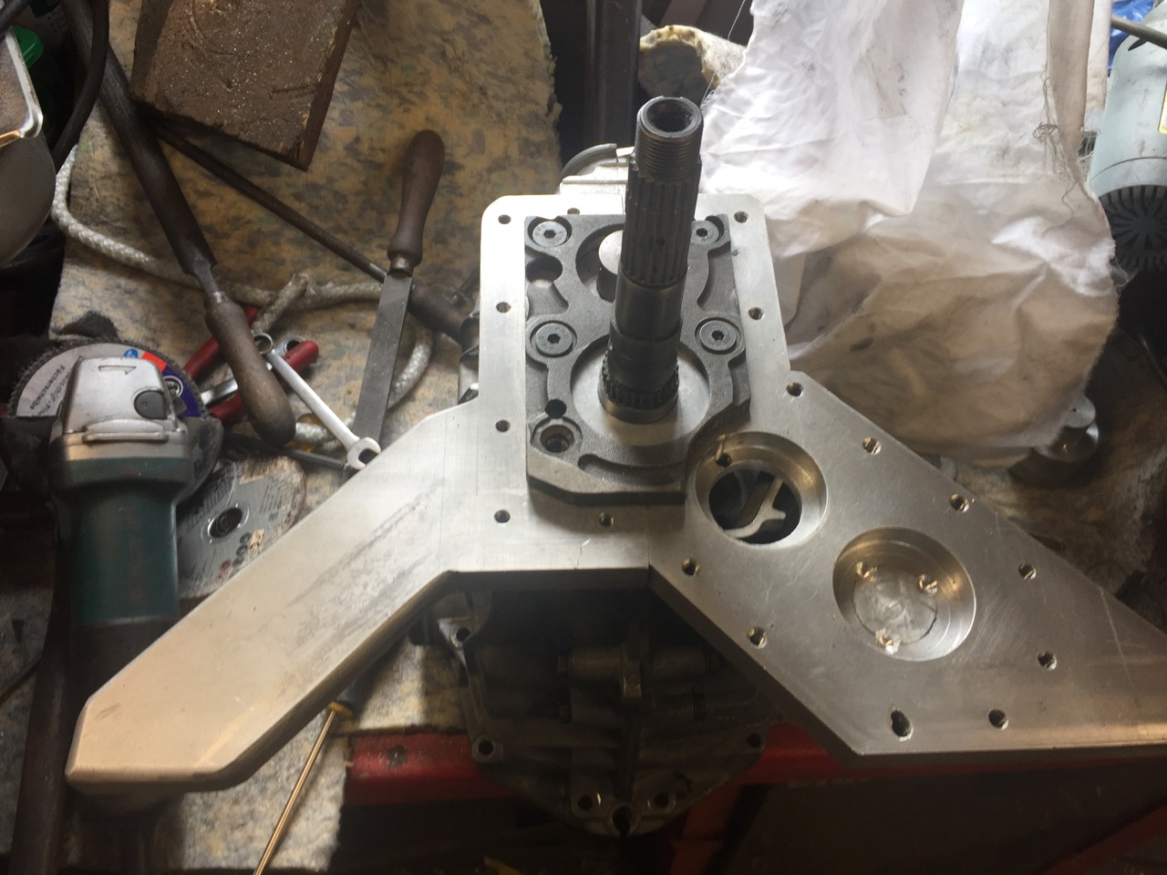

The back plate, 2 halves, alll lined up ready to be welded to the main gearbox case!!!!
Shortened Main Shaft.
Needs to be threaded to take a 20mm Nut, however a bastard of a job as the shaft is very hard :cry:
March 1st, 2017, 1:17 pm
Posts: 2251
Now with M20 nut. :D

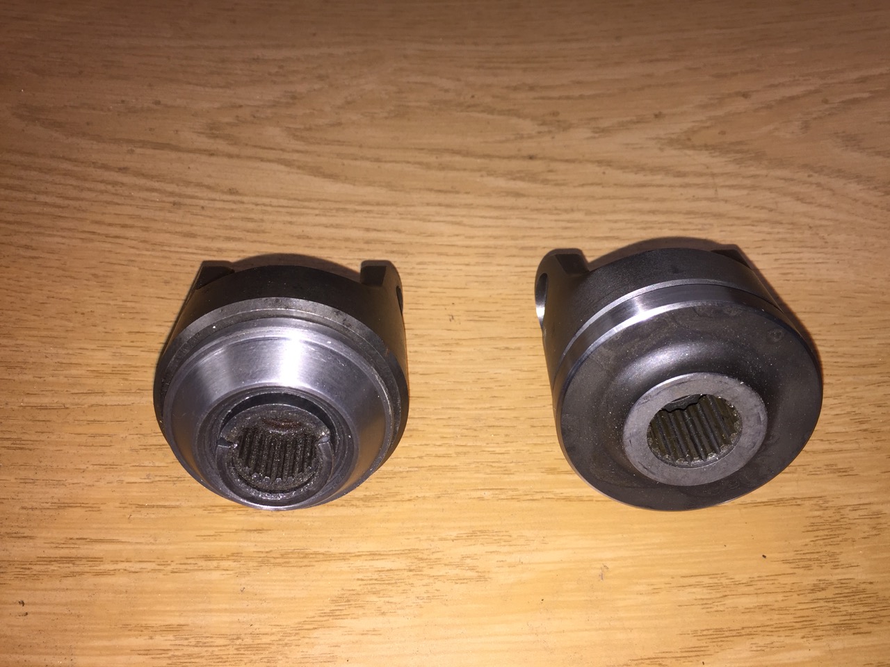

While the gearbox case is being welded, set my mind on the transfer shaft that runs at engine rpm and connects between the font diff housing and the remote 4 speed gearbox.
Found a couple of cheap Kawasaki drive shafts which are good to 9000+ rpm.
Splined parts fit the rear of the layshaft and the front of the layshaft, just need to be very carefully TIG welded.
Pics...
Shafts with splined parts
Overview
March 11th, 2017, 11:41 am
Posts: 2251
Propellor Shafts Parts
