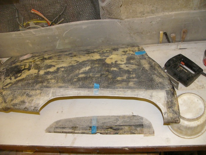

A tip a professional gave me regarding blemishes and shaping.
Spay on a light coat of a colour (a mask) other than that of the wing. Black is common. Rub back with a block and this will show the high and low spots as the mask is rubbed down. Try it with a can of acrylic as this will interact with other other types of paint.
Its easier to see the effect than it is to explain.
Probably to much catylst used and the heat caused the distortion. ;)

no.., lack of catalyst ..so the gel was not cured before the laminate was applied. Have to say I've done the same mistake myself :oops: ..happens in extremely cold weather too ..and when there's a breeze over the mould (evaporating the catalyst before it reacts).
The thing is ..we all make mistakes now and then. And it's usually best to deal with it professionally ...rather than to waste time and materials in producing something that isn't fit to sell. The remedial action in this scenario is to paint the soggy gel over with neat catalyst and then to apply just a single layer of fibreglass mat (of normal catalyst mix). Trapped under the glass layer - the catalyst will cure most of the gelcoat. The grp mat will then aid getting the gel out of the mould. And then scrap that panel. :ugeek:
Anyways up... moving on with what we have.
needs a bit of tweaking too..
