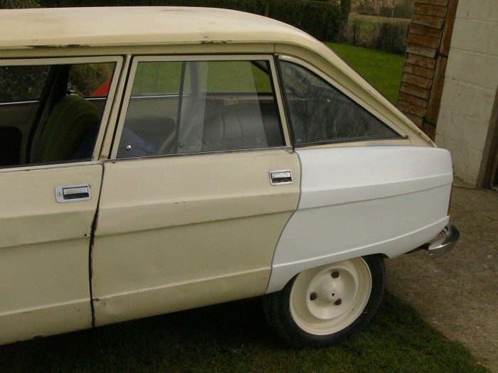

As promised, latest on the Ami Super ;)
..the newly reshaped rear wing (with cut out arch) hand painted in epoxy primer. It's not yet attached, but just resting there for the piccie.
I'm happier with the look (than with the standard wing), and it'll be so much easier to change the wheel now ..as & when that's necessary.! It's a better fit now than the original steel panel, and it'll not rust.. 8-)
Moving on.. I've stripped off the paint of the RH side rear wing and found it to crap (manufacturing fault insomuch as it looks as if someone forgot to add the catalyst to the gelcoat and so it rippled badly and cracked. The panel is also badly distorted. :( I've had to grind most of that gel off to get down to a more stable substrate (the actual glass fibres) so now am faced with the formidable task of reshaping it :roll: hey ho !
