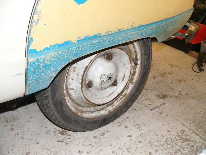

not what I've done today, but this past week..
I've been replacing the steel rear wings on Sami, my Ami-S, with grp panels. The original (1974) panel although dented and with minor rust is perfectly restorable., but I didn't want to cut and shove it.. and yet I wanted to change the design slightly - to have a rear arch cutout, not dissimilar to that seen on the M35.
Not only do I feel this helps visually balance out the car a little better, but it should also help when changing the rear wheel.
Because the standard arches are so low and closely tucked under, this involves jacking the car wwaaayyy up in the air - until the wheel drops down sufficiently to get the dished wheel clear of the brake hub & its studs. And if you don't want to scratch all the paint off the inside of the wheel, then you have to crawl under the car to see what you are doing :o
The lack of lateral clearance means the Ami is even worse than either the 2cv or Dyane. And in the event of a roadside puncture (or in a field car-park as I had last year) where the ground is neither level nor firm - then jacking the car up so high is (imo) an unnecessary risk. So, it was either a case of making a removable spat, or a cut-out arch. Personally I prefer the M35 look.., which also happens to be the easier option ;)
^ Sami ..as was. The original wheels had been rubbed down and repainted over the previous week.

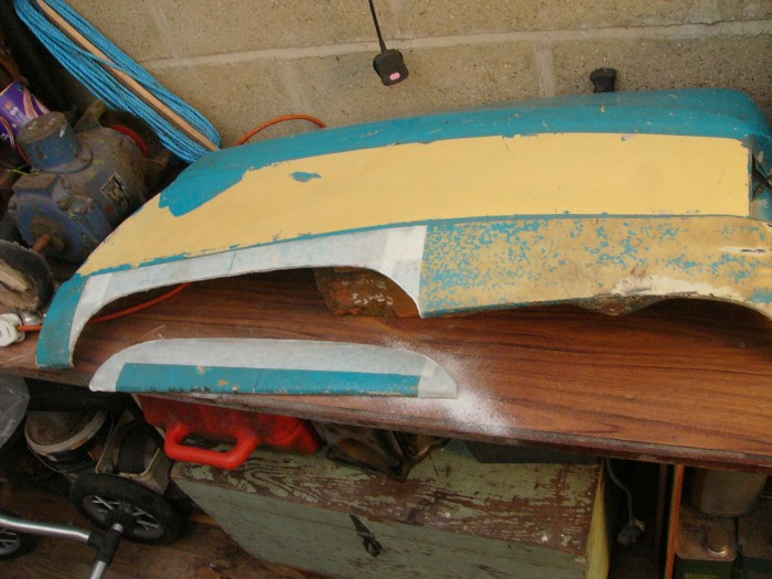

^ old grp wing acquired, trial fitted & marked, cutout shape defined and cut out. You can get an idea of how flat that panel was in way of the wheelarch out out. And it was like this before I cut it.

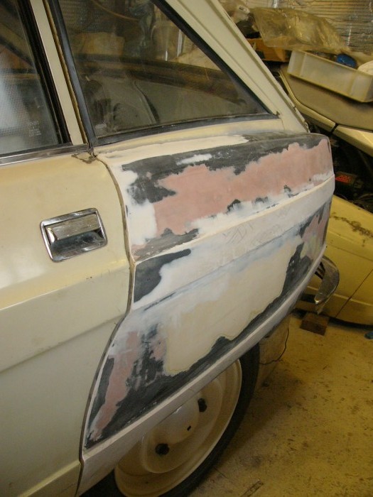

^ most of the previous paint and filler removed (hand scraped as you can't use chemical or blasting with grp). Then I trial fitted the rear light, dug out air bubbles (..from crappy manufacturing quality), refined the panel to body fit, and assessed the general shape (grp panels have a habit of flattening out if not stored properly whilst fully curing). I then set about fitting a bowed batten to correct and hold the panel's shape. NB. The original steel panel has a similar reinforcement running parallel with it's bottom edge.

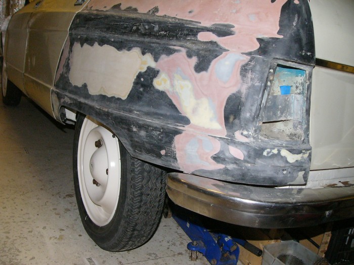

^ much better wheel removal clearance and line 8-) But the shadow lines (edges of the relief) had been rounded off too much (not by me !). Body workers with da in hand forget the fibreglass is not steel ! - it's only as hard as body filler., so the defined edges tend to get lost.
