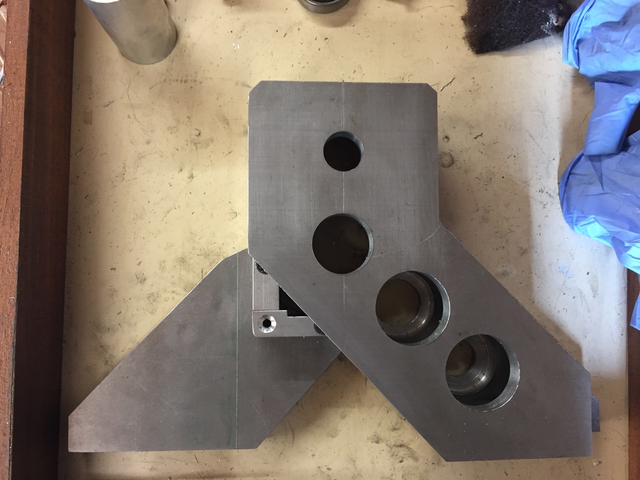

February 11th, 2017, 1:51 pm
Posts: 2251
One hole too many :( :(
