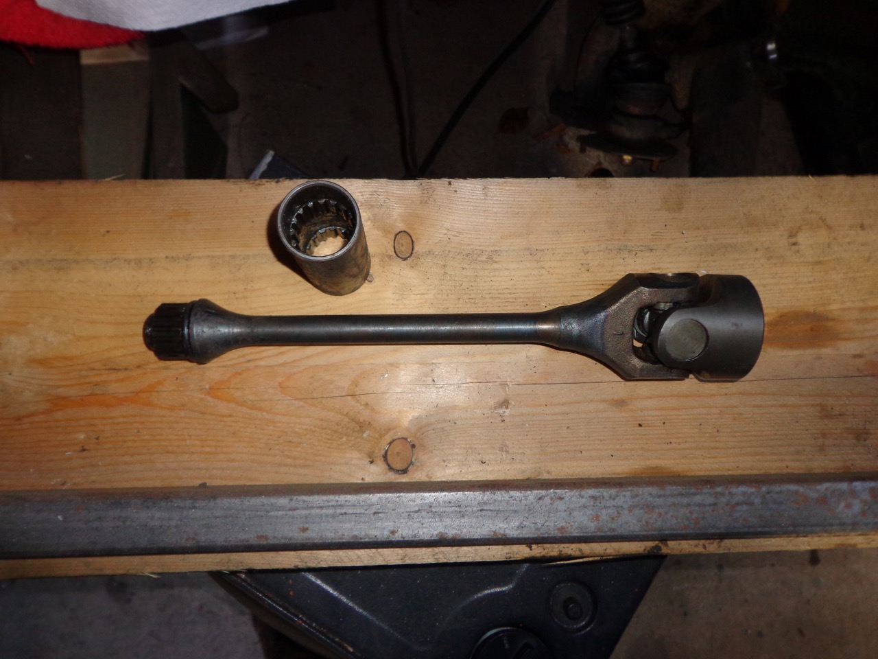

Posts: 2251
Ebay again..
Found a Kawasaki GT550 prop shaft (x2), good for 9000 rpm.
The two shafts joined together with a UJ at each end will connect to the remote 4 speed gearbox.
