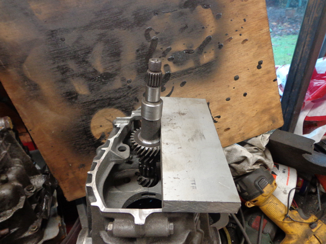

Spent 2 days taking the milling machine apart to remove a jammed adjustment wedge, that had come loose, now re-assembled and working :D :D :D .
Also Turned the 4th gear "off" the layshaft, this will be the power transfer shaft to the remote gearbox
Power Transfer Shaft.
Power Transfer Shaft with Drive Flange.
