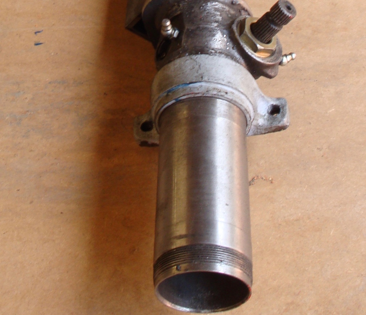

Spoke to Roy and have gone for the 9.0:1 kit, will hopefully fit them next week. While fixing stuff, I decided to fit a new guide ring bush to the steering rack that has been a little slack for years. That side of things is fine, however the top pinion bearing is a little crusty. The bottom needle bearing is fine, but I'll replace the ball bearing that sits immediately under the slotted nut / seal. Does anyone know the dimensions of this bearing off the top of their head? I forgot to take my verniers with me, and now it's locked in a barn I don't have access to until next week :roll:. I can't find it listed individually on any 2cv parts site either.

Needs this
http://www.ecas2cvparts.co.uk/steering- ... -1553.html
or
http://www.ecas2cvparts.co.uk/steering- ... -2107.html
Add grease nipples 1 for the pinion 1 for the top bearing

Thanks for that Pete, I have a stash of grease nipples ready to stick everywhere :)
Does the lower grease point on your picture there cover both the needle bearing and the pinion?
Is the top bearing not separable from the pinion? I don't have access to the parts at the moment to check, the pinion itself is in good condition, the teeth and splines are fine, but the bearing is a bit rumbly. I was hoping to just replace that.
June 2nd, 2016, 8:17 pm
Post Re: Albert the AKS400
The lower grease nipple only the serves the pinion.
The needle roller may get some overspill, but mine never seem that bad.
The pinion/bearing are combined the inner race is the pinion shaft.
If the bearing is noisy its on the way out.
June 2nd, 2016, 9:20 pm
